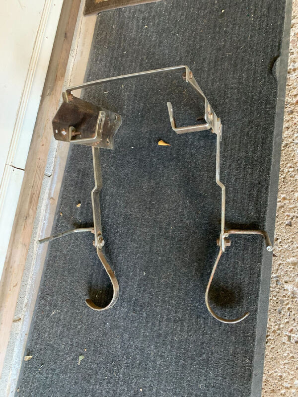

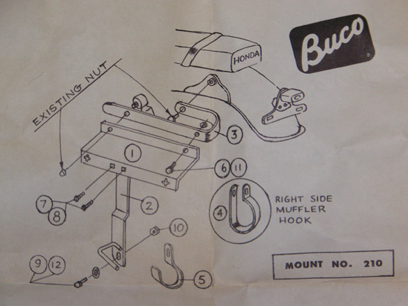

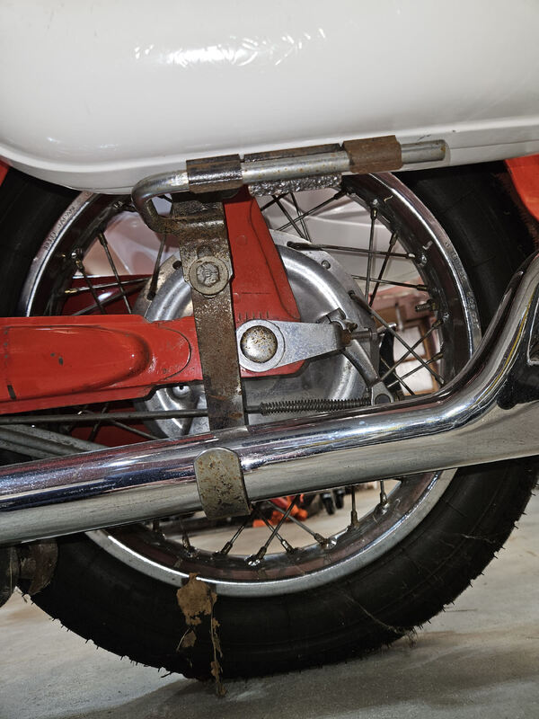

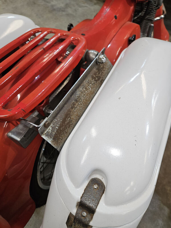

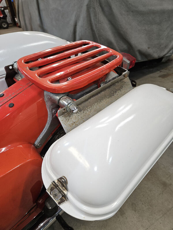

Re: Buco Twinmaster Saddle Bag Mounting
Thank you Michael, that would be greatly appreciated.  The mounting system I have is for a BMW I believe, it has rounded hoops that the bag brackets bolt too,  It is also missing one piece, the long bracket that has the bar that snaps into the bottom of the bag (#2 in the attachment) and there are no muffler clamps.  I have not be able to post any pictures, the response is the photos are too large.  I am thinking I am going to have to fabricate some additional brackets in conjunction with what I currently have.  I am a attaching a set of Buco mounting directions I found on the web that show a system similar to  the pieces that came with the bags.  I have been a member here for quite awhile, done a number of CL77's but this is my first Dream.
