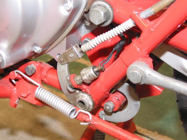

Hi all where does the rear brake light switch mount, the old broken switch with no spring is just hanging down, is there a welded bracket or am i missing a bolt on bracket.

There is/was a steel ring welded to the frame at the junction of the frame bottom and the leg which goes APX. 45 degrees to the rear. ...........lm
