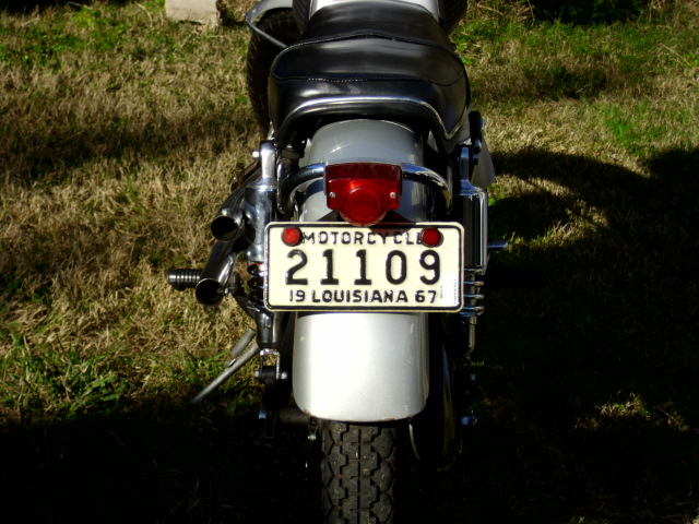

Well, I guess the good old boys (and girls) at the Louisiana DMV thought they could wear me down.... WRONG!!!
After applying on 11-10-10 and several phone calls to various uninterested people, I finally received the registration for my 1967 M/C license plate today!!!!!!!!
Another long term project for my '67 CL77 completed..... didn't start out as a long term project but it sure morphed into one.

Looking good!
Haven't been able to locate a 66 WV plate yet, so I got a regular vintage plate in the meantime.
The vintage plate developed a nasty crack thru the mount hole from the vibration before I noticed it!
Maybe this problem is confined to the Dreams, (like cracked rear fender syndrome?), but you might want to keep an eye on it.
I ended up insulating the plate with some rubber washers.

Great idea about the rubber washers Brew, that plate deserves a little extra love!

You could probaby find a pair of grommets that would fit the plate holes and then slip a couple of bushings thru them and use 10-32 screws and locknuts to hold the plate on. Might need fender washers on the plate bracket since it is really sized for 6mm or 1/4 bolts. But that would completely isolate the plate. Will probably do it with mine when I run out of more pressing things to finish on the bike.

I bought four of those thin, stiff rubber fender washers from Harry's Ace and sandwiched the plate with them.... worked great.

Or, cut a backing plate the same size as the liscense plate, either aluminum or thin steel, and use all 4 bolt holes.
