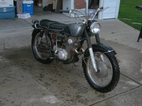

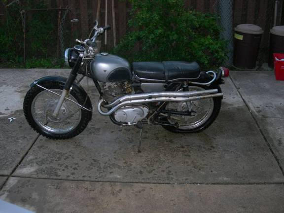

Thanks RW for the tip, I wasn't quite sure how to adjust the points but the FAQ section you steered me too makes it pretty straight forward. Also, the VIN # on my bike is CL77E-1048803. I think its a 1967 Scrambler but not for sure mainly because the gas tank isn't made to carry any badges. I'm thinking this may be an aftermarket tank because I have never seen a picture of another Scrambler that didn't have badges. I've attached a couple pics.

Re: CL77 VIN #
The numbers and pics do show a 1967 issue bike.
The tank has had the badge area filled as oh so many had back when they were everywhere ya looked and the owners wanted theirs to be DIFFERENT.
Do get the engine running and ride it some then time will tell what the trans will do. ..............lm
