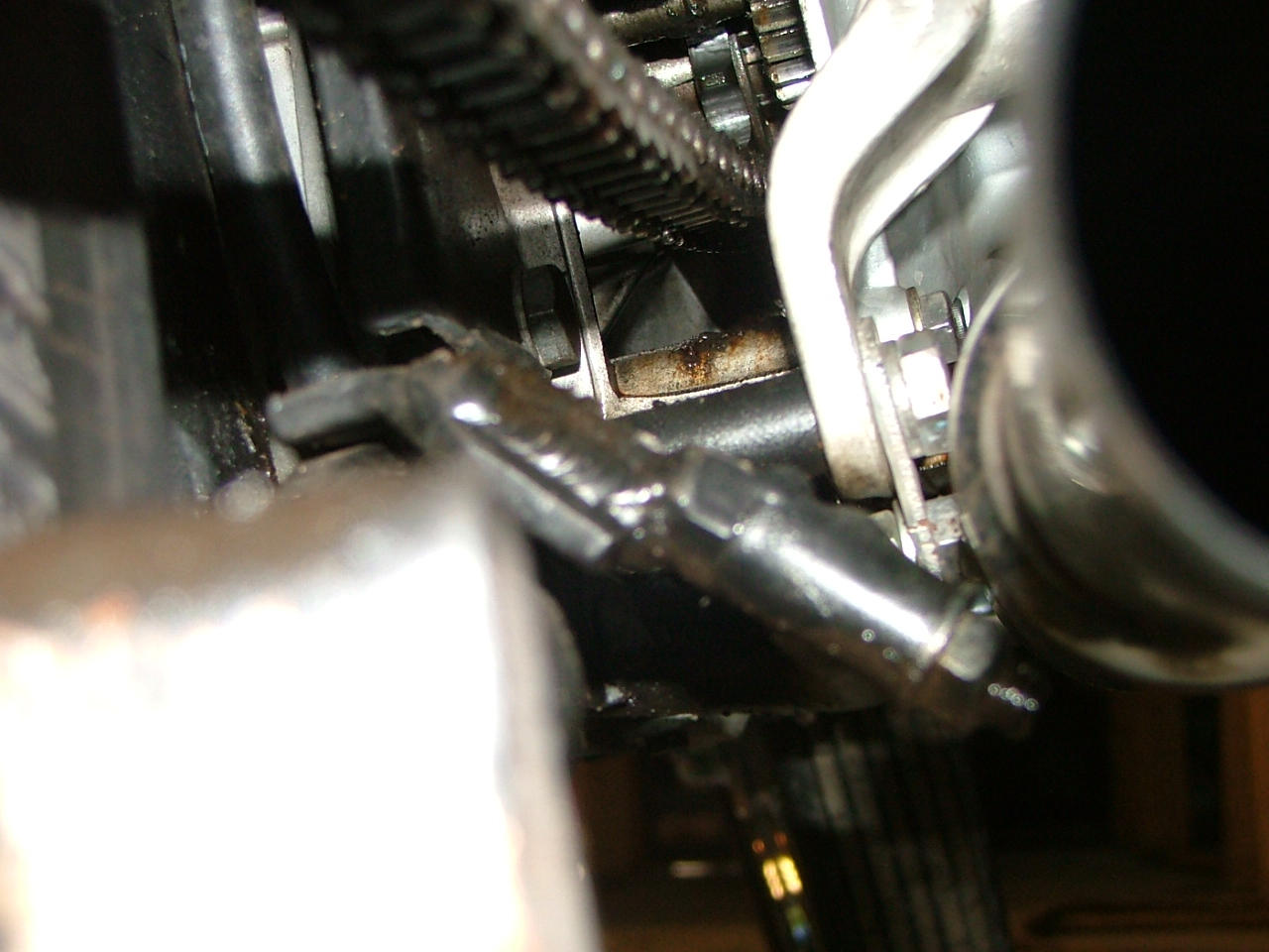

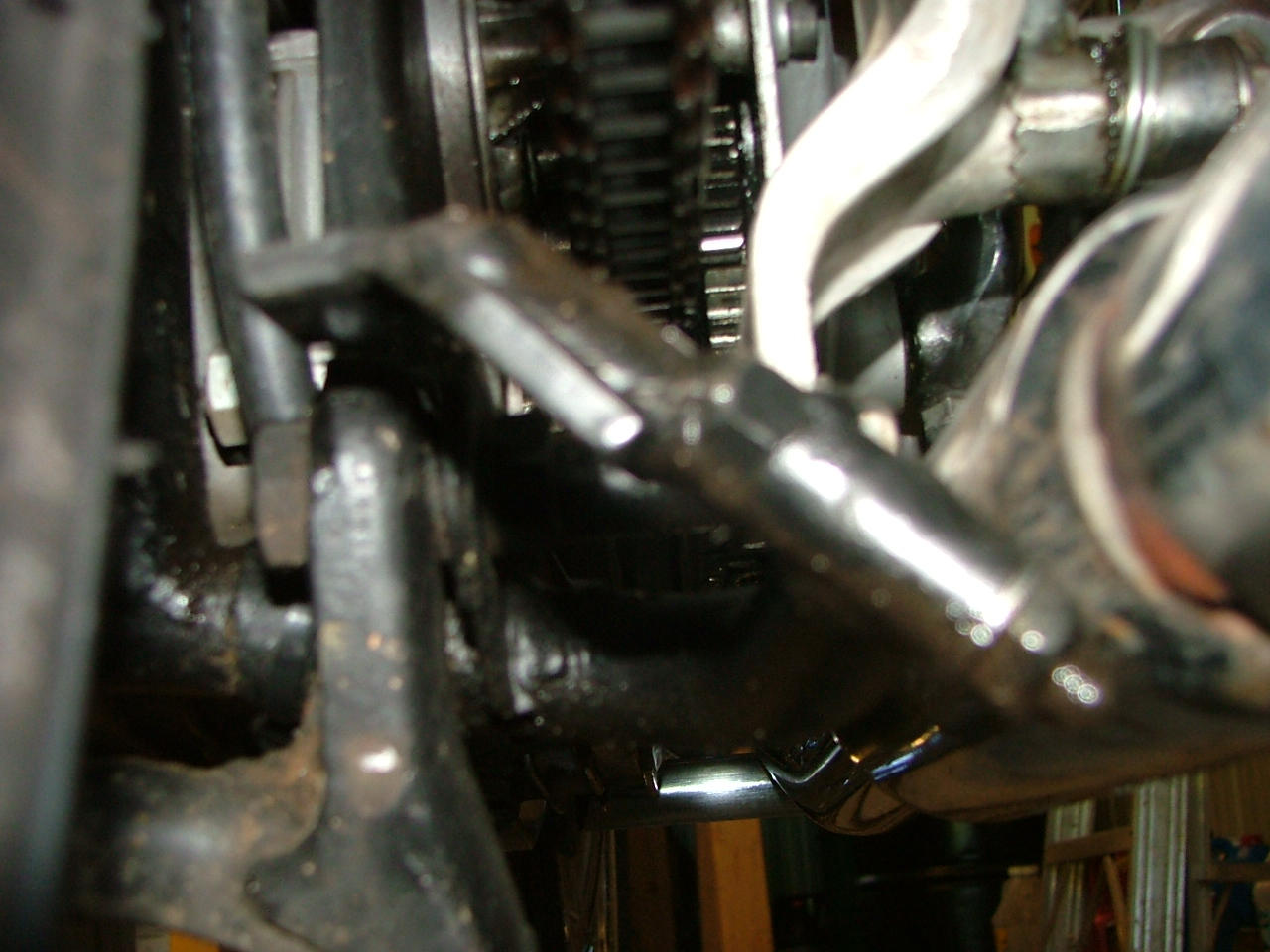

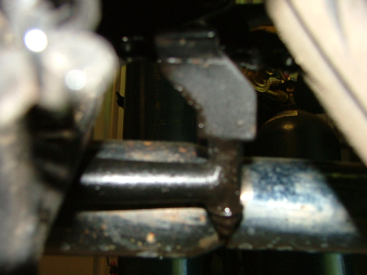

Fabed stop for center stand
Post by Goodysnap » Sat Jul 03, 2010 9:15 am
Not much really, just something I threw together with the welder. I used a carriage bolt on the other side in the same hole for the sidestand stop.
