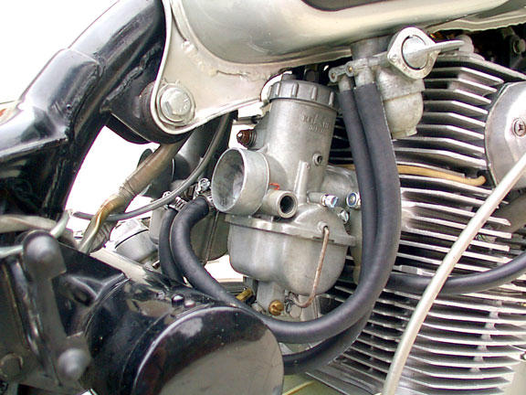

Here's another oddity. Check out how the tank was cut to accept the carbs. What's strange here? Doesn't look at all like my old CL72.
Thanks
MortimerSpooge
Posts: 16
Joined: Sat May 01, 2010 10:30 am
Location: tn
Post by MortimerSpooge » Sat May 01, 2010 9:42 pm
I do not believe that bike was originally fitted with vm mikunis
DONZIE
Posts: 124
Post by DONZIE » Sat May 01, 2010 10:06 pm
Some one fitted that rear tank bracket of another tank. Find the correct tank
MortimerSpooge
Posts: 16
Location: tn
Post by MortimerSpooge » Sun May 02, 2010 6:44 pm
Well after lookong on a larger screen I see they aren't zinc mikunis but correct carbs
