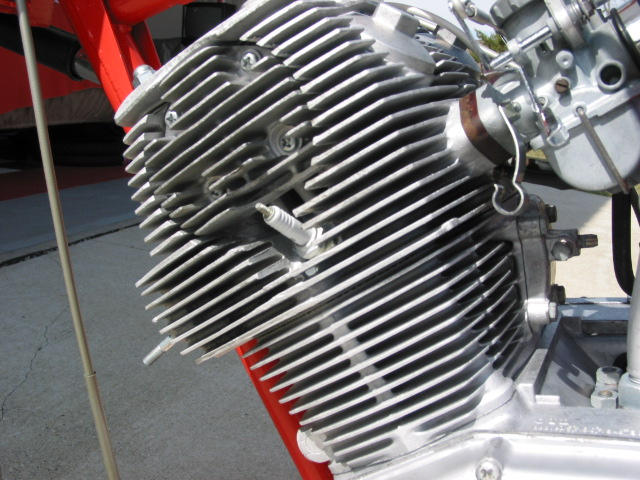

Jeff, I have come up with a method I use on my new builds, but I have never tried it on an assembled engine. I have tried air conditioner core acid, have bought 2 quarts of "Metal Finishing" cleaner and acid, have tried every chemical solution I've ever heard of - none have replaced mechanical action. Since you can't burnish an entire engine and these machines aren't available to the hobbiest, I kept experimenting until I found this -
I degrease/clean the part before ever starting. I then use my portable drill to turn a thin 1/4" wide long-bristle brush of at least 4" in diameter. I secure the part and using the drill, use the mechanical contact to remove oxidation, scale, and bring a luster back to the part. My KZ900 was done 1 year ago when I rebuilt the topend, since then I've done the Suzuki head and have had good responses from other boards I've posted this on. The key is to find a thin, long bristle brush that won't leave scratches and be flexible enough to fit down in-between the fins. My CL77 will certainly be getting this treatment. These were done 100% by me with the simple application of a narrow brass brush spinning in a portable battery-powered 3/8" drill.

Here are the results -

Here is the head and cover - not a great photo, but these are not cleared and I did the work back in 2008 when I built the engine.
Also note, a bench grinder with a wire wheel will not duplicate the results - it is too fast or the bristles are too hard. It is the slow action and the long, soft bristles working down in-between the fins that mades it work without scratching and gouging the surface.

Those are all great options. Make sure there isn't any oil or grease with the soda blaster otherwise you'll end up with a gooey mess. Good luck cleaning her up.
The red scotchbrite pads fit wonderfully in between the fins for touch up as well.
