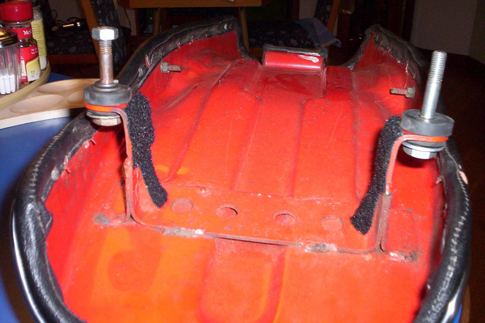

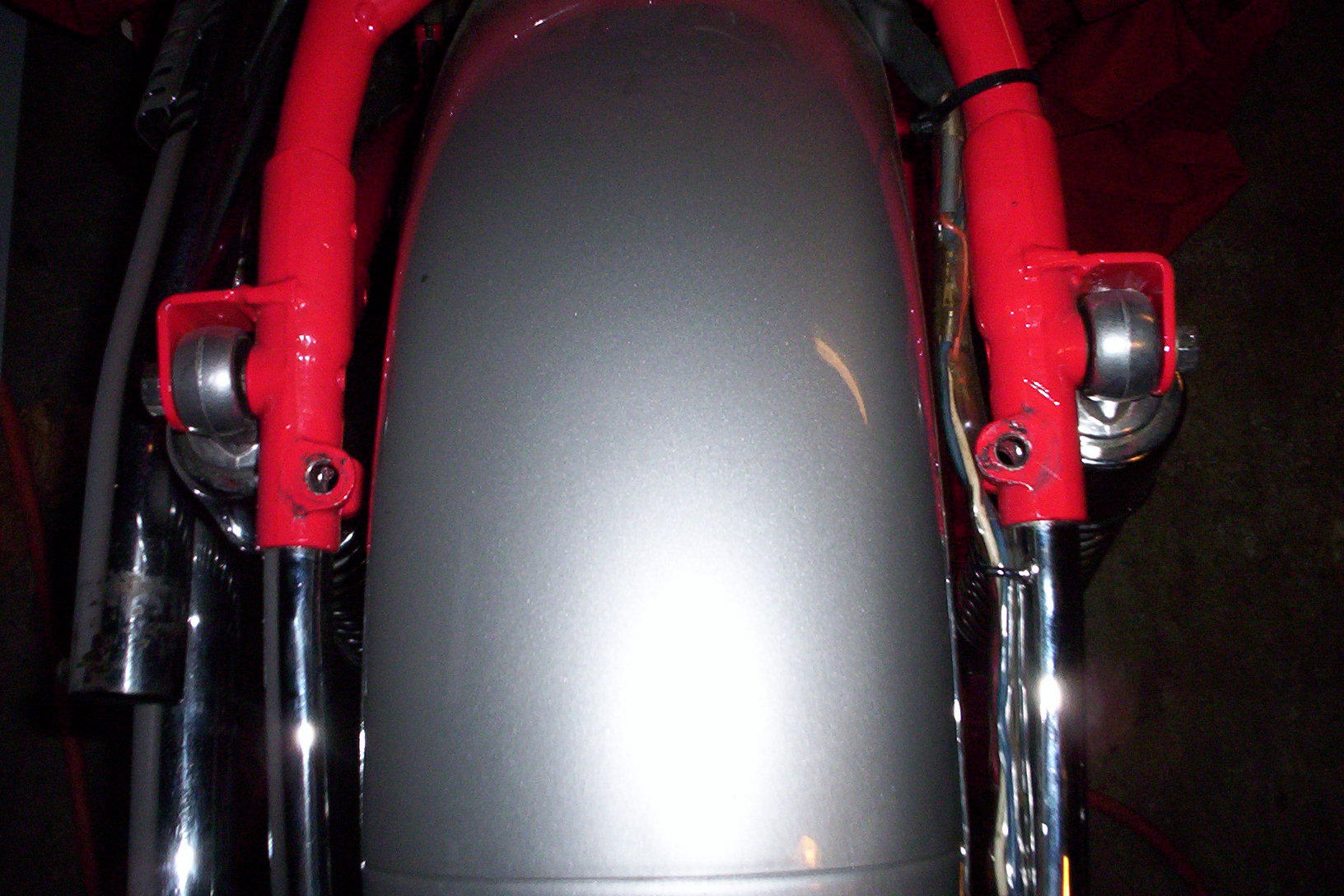

These photos show how it goes; the chrome rear bar slides into the rear of the frame until the reliefs in the bar line up with the bolt lug holes. The bolts that attach the seat to the frame pass through the holes thus locking the chrome bar into place. Make sure the rubber grommets that are installed in the seat pan holes which the bolts go through have the thickest part on the underside otherwise the rear of the seat will rest on the rear fender and damage the paint. Don't ask me why I know this.
George
George
