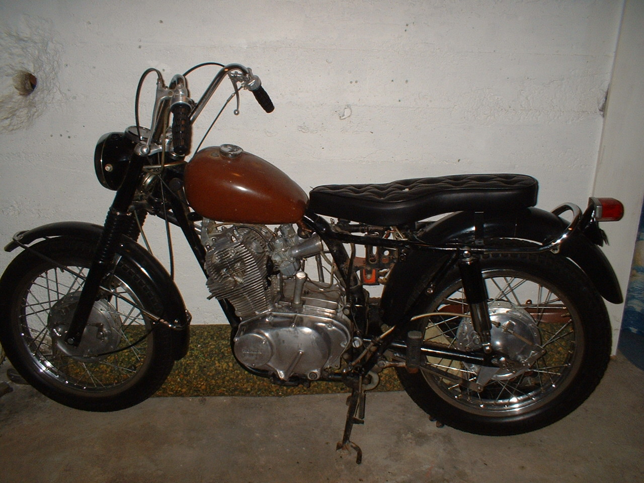

I got the valve head back from LOUDMOUTH and it looked brand new. When I took the cylinder head into be bored I asked that they bead blast it also. I had cleaned it up but nothing like the valve head. Couldn't go around with a two toned engine! Been painting parts and waiting for the cylinder head to be done. Should be today or tomorrow. Expensive compared to the asking price in some of the posts here but Hey-- at least I am getting it done. Little apprehensive about the cam chain . No clip on master link but I'll give it a try anyway. I hope not to give me a black eye but here is a before picture in the basement.
before
before
