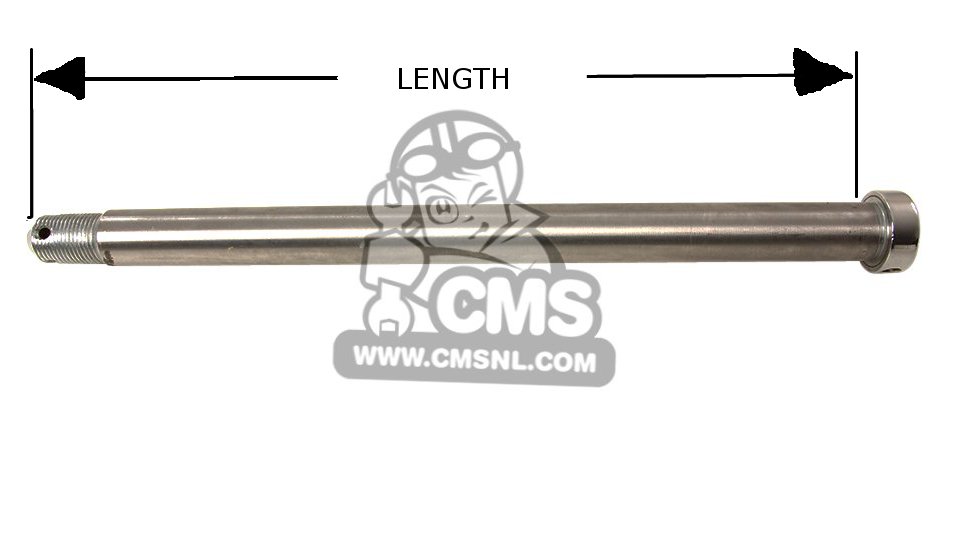

Does anyone know the lengths of the CL72 rear wheel axle, there appear to have been 3 different setups, 2 for the single leading shoe and 1 for the twin leading shoe.
SLS
42301-273-000 from CL72-62 20002 to CL72-64 1107409
42301-273-010 from CL72-64 1107410 to 1008850 ; CL77 1000001 to 1014495
TLS
42301-273-030 from CL72 1008851 to ?end ; CL77 1014496 to ?end
Each axle had different spacers and swinging arms, the adjuster appears to have been changed at the same point but the 3rd change used the R/H one on both sides.
I believe the swinging arm changes relate to the first dampers having eye fixings top & bottom, the second eye top and fork bottom, the third changing to TLS brake.

Just got my '62 spindle (eye to eye swingarm) back from the platers. I'll measure it when I get a moment.

Thanks Graham, it would be interesting to find out the spacer dimensions too, I have looked to see if this information is listed somewhere but no luck. Also puzzled about the different adjusters especially using 2 right hand ones on the last setup.

The spindle(axle) I have is 300mm long with the cotter hole at 290mm.
