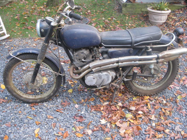

Post by Peter Murray » Sun Oct 19, 2014 5:36 pm
Just sending power your way, that baby was just a bit crusty. Looking forward to progress. Your bike makes mine look like showroom.
