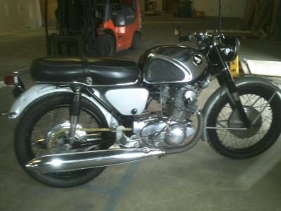

hey guys, my bike is titled a 1964, but i have a frame 101376 and engine 101380. i know its of the older bikes, but i suspect it may be a 1961? please advise
Post by davomoto » Thu Jan 05, 2012 2:11 pm
Numbers suggest a 64. Does it have the speedo ring cast into the upper triple clamp? Breather tower on upper rear of crankcase? Pics are helpful.
Davo

no bracket but it does have a breather tower.
Post by rickytile » Thu Jan 05, 2012 3:52 pm
it does not have that early 61 bracket on the triple tree iunfortunately but the enigine def has the breather
after my restoration

but the other 64s usually have 7 digits not six
Post by rickytile » Thu Jan 05, 2012 3:54 pm
usually i see 7 not six digits in the 64-65 vins, so i thought this may be older.
Post by davomoto » Thu Jan 05, 2012 4:09 pm
I don't see the breather tower. 6 digits through 64. 61s start with 11, not 10.

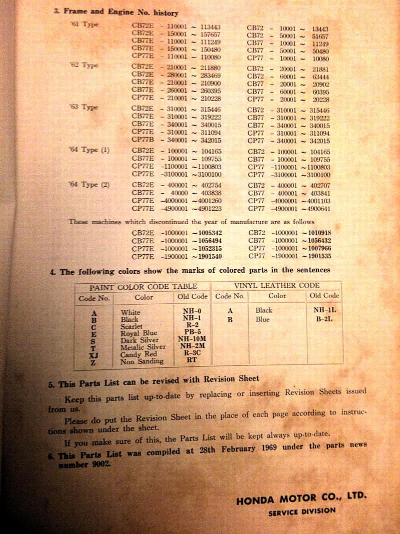

Post by G-Man » Thu Jan 05, 2012 4:17 pm
Looks like '64 to me too. These number may help. Apologies for quality....

ok i see. well its good that its original then
Post by rickytile » Thu Jan 05, 2012 4:22 pm
ok the breather i thought was on the "breather plate" but i see what you mean on the crank case
