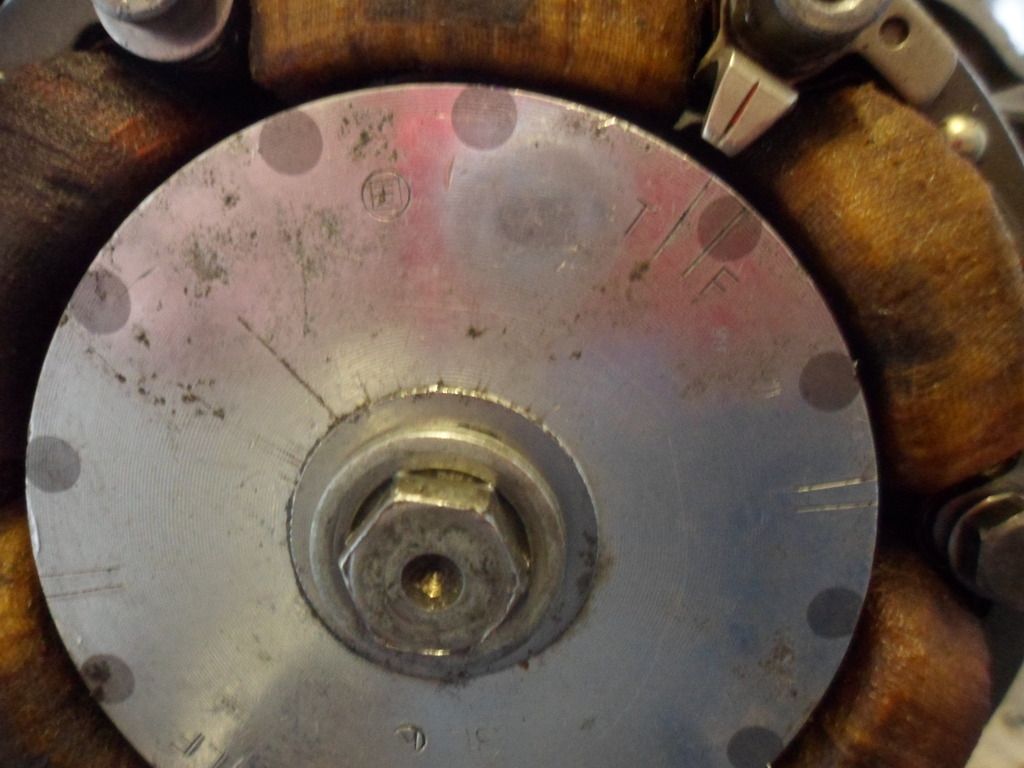

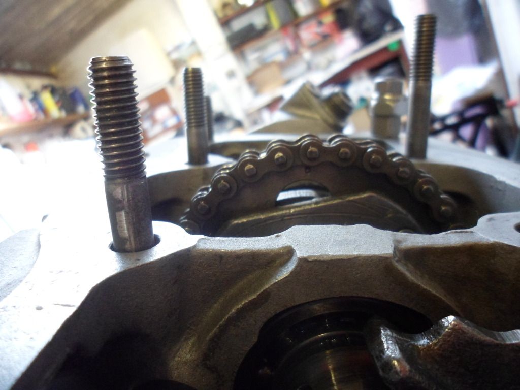

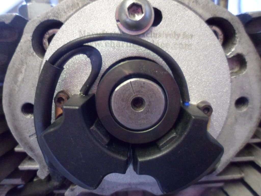

But I have just put my 1964 CB77 back together and now it will not fire, I belive I set the cam timing wrong here are some pics of how it looked when I set it up with the right hand piston at TDC, (I now belive it was not on the firing stroke).
I understand this should be at 12 0 clock.
The 0 is at top the camera is angled to the left.
So now I find with the right hand piston at TDC and both valves closed and T on rotor and the scrib mark on the end of the points cam is pointing down, and bike will not start.
