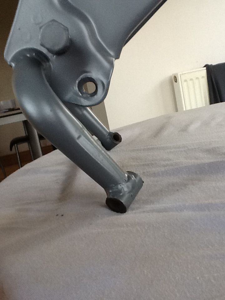

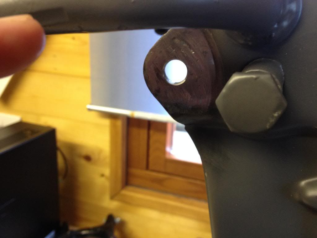

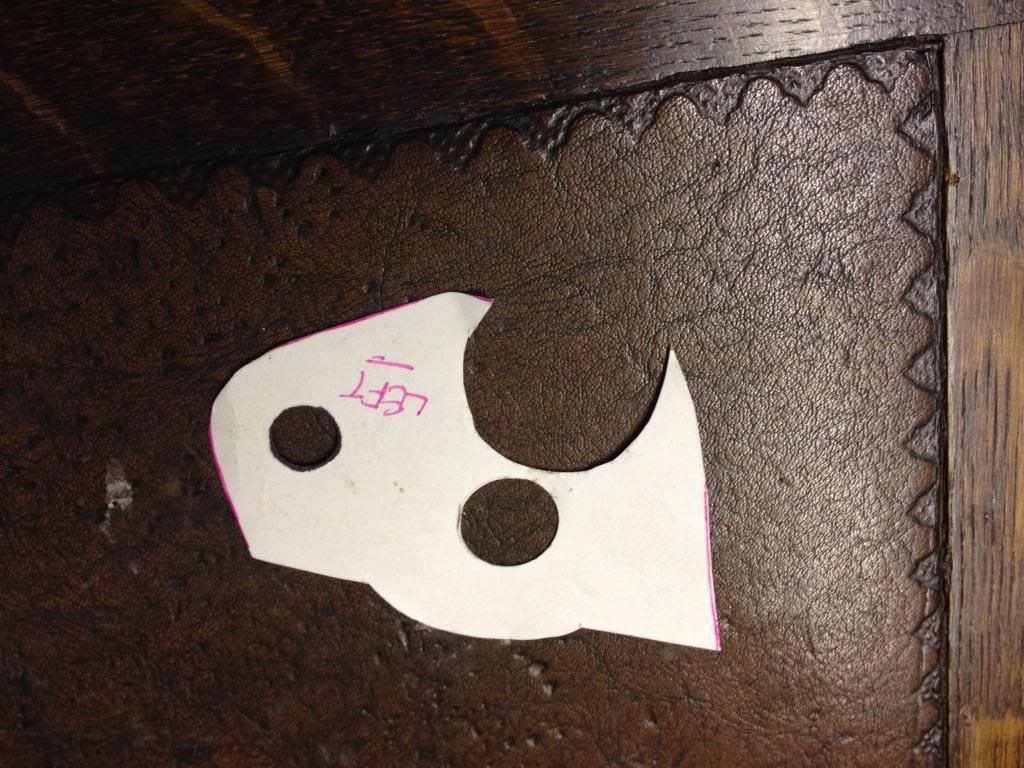

My 61 frame has some issues with the centre stand holes being oval . i made a little template then had the holes welded up, so i could re drill them.
re drilled

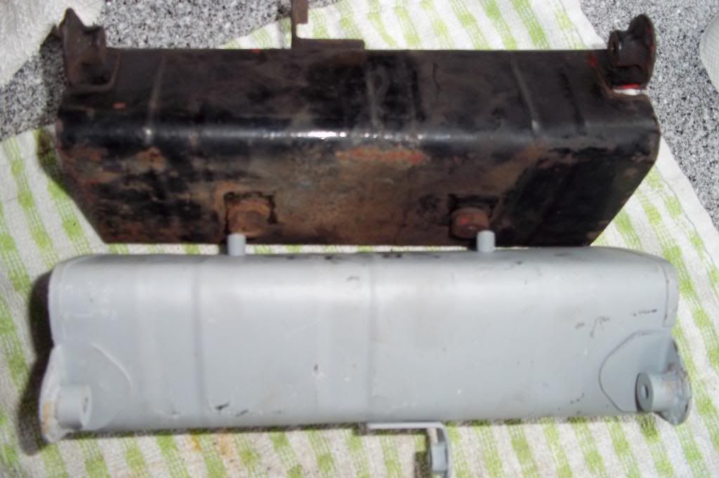

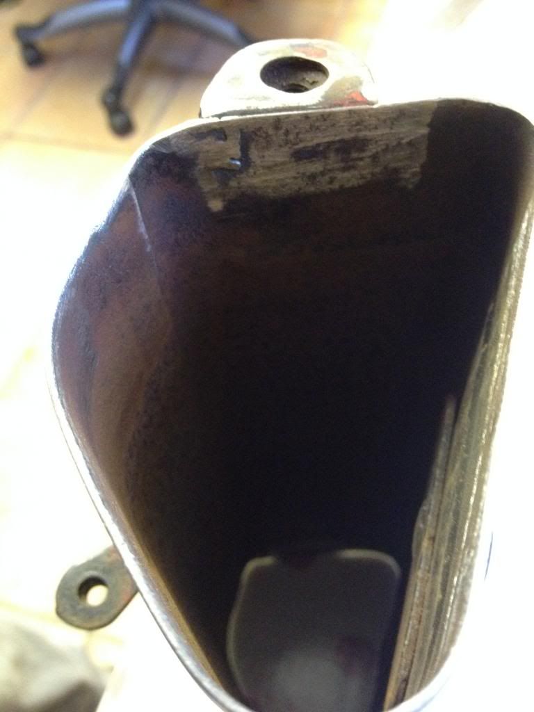

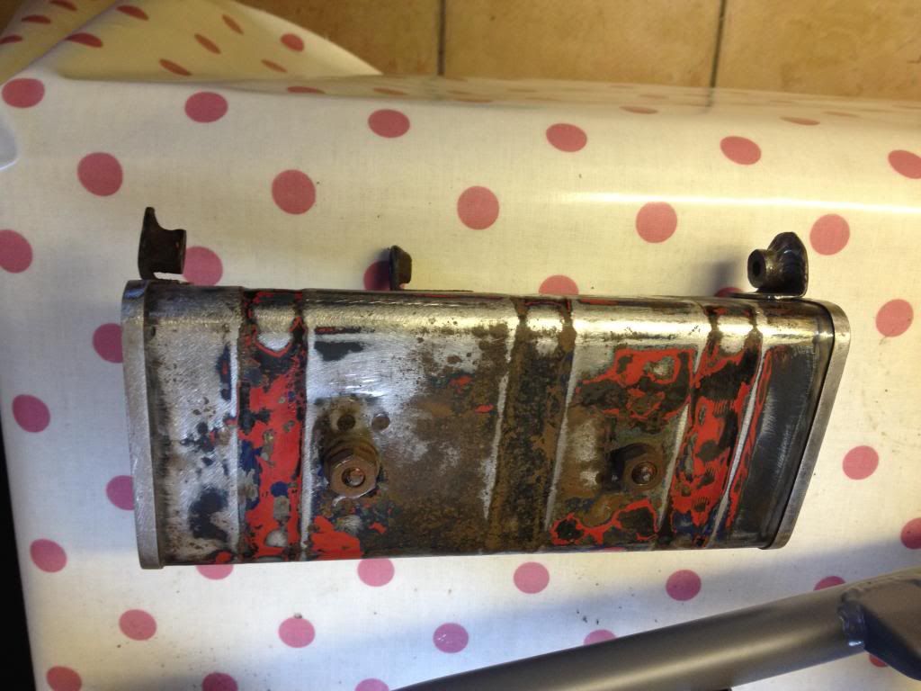

also had a issue with the tool box, so i thought i would get a better one, found a NOS one , but when it came it was a different size, the mounting holes was in a different place.
also the nos one had a little strip welded round the edge, which i had done to make it a lot stiffer, that should stop it splitting again, there was also other difference's with the starter solenoid bracket was a different size.

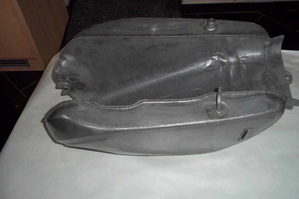

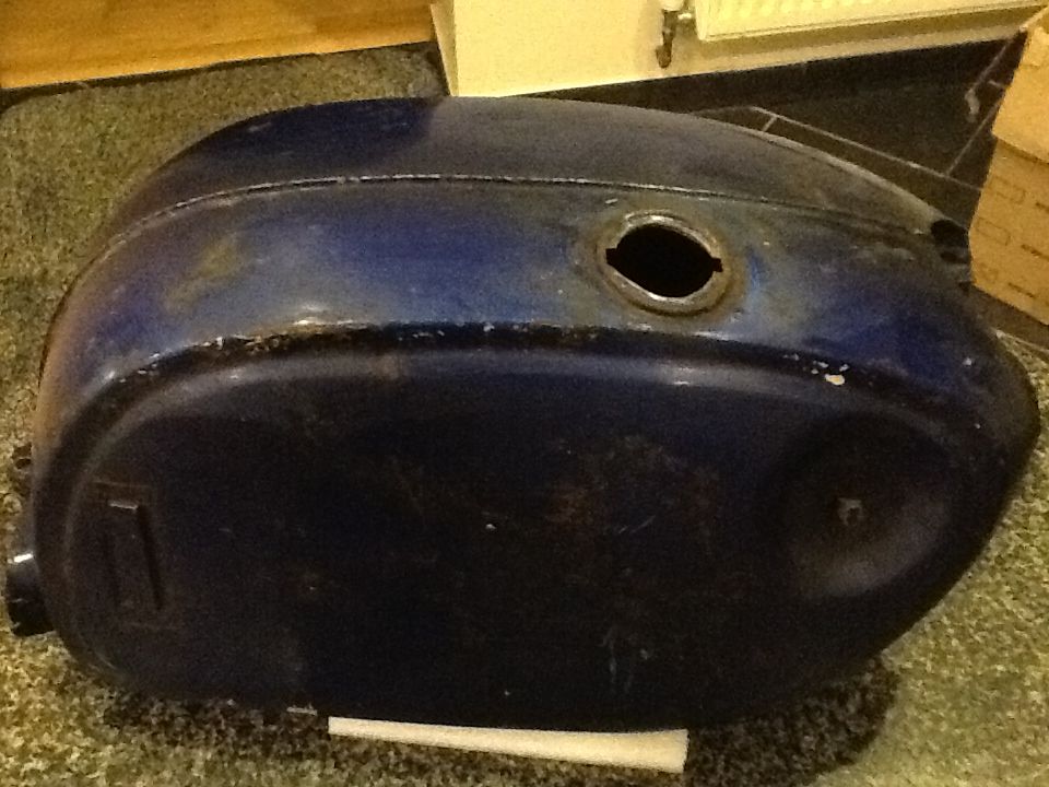

had tank dipped in acid

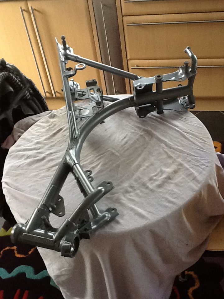

frame powder coated in primer.
