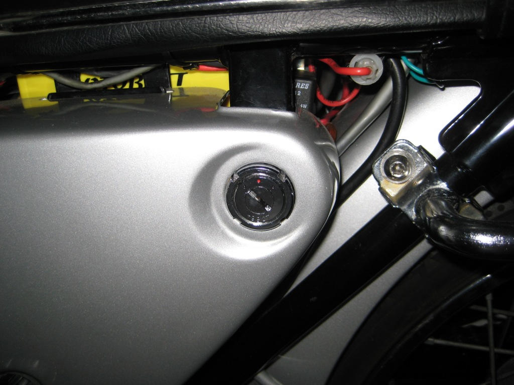

Post by Gunner_CAF » Tue Aug 31, 2010 8:39 pm
Here is how mine is mounted. It mounts to the frame and is accessed through the hole in the side cover.
Gunner

Post by bonjour » Wed Sep 01, 2010 10:29 am
Ah, now that makes some sense !
I already thougt that I could never get the side cover of, without messing around with the wires, wich didn't make much sense also.
Thank you very much ! Im sure it will work now.

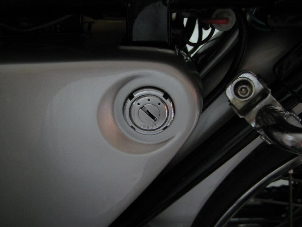

Post by e3steve » Thu Sep 02, 2010 10:57 am
There's a special, chromed nut that retains the ignition switch (the term 'combination switch' refers to the 5-position ignition/lighting keyswitch found on C/CA Dream [touring] models) and fills the aperture in the side cover. I'll post a pic tomorrow unless someone beats me to it.
Posts: 2601
CB ignition switch in place
Post by e3steve » Thu Sep 02, 2010 1:00 pm
Pic herewith, as promised, bonjour.

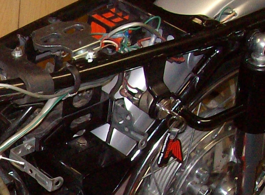

But yesterday I made a terrible discovery, it turn's out that the prev. owner cut of the 'switch holder' as you can nicely see in the pic. of Gunner.
Here, if you look closely, you can't see the nice switch-holder :
The guy just cutted the holder off, So I have to improvise and make something myself for the switch.
I don't want to weld on the frame, so im going to make a holder that is '(de-)mountable'
Ah well.... that's the charm of having an old bike again !
