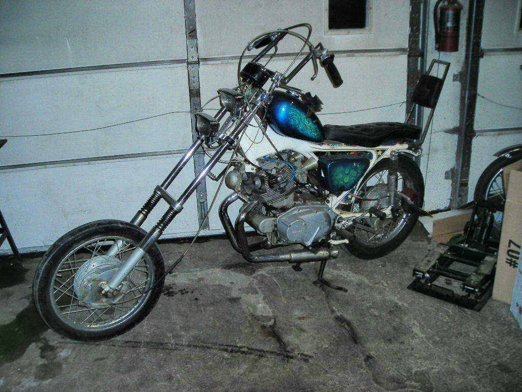

Not really an expert, but depending on condition of bike I'd say don't do anything that can't be undone to bring bike back to stock, and save the parts. I've got a funky rear fender suitable for chopping if interested, crunched at rear, front's ok. How about of pic of bike you're starting out with?

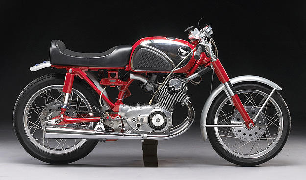

Your inspiration example looks pretty mild and reversable compared to lengths some guys go to. Steering yoke off an early (61?) model, and fancy seat could be expensive. I think a longer linkage for shifter will allow you to move pegs back easily. Steering damper off a CL, not sure it's necesssary. Why remove rotor/stator cover, it doesn't weigh that much. Speaking from experience, clutch cable routed outside tank will flap in the breeze, distracting.

I was thinking of doing the steering damper thing too on my bike, but I think you might have to get the bolt for the lower triple tree machined, as I don't think it's available (not sure how they do it on a CL). The upper right motor mount has to be replaced, as that's where it mounts (that part is about $ 65.00). A real CYB steering damper is about $ 300.00 or more (don't know how it differs from a CL version), the seat might be as much as $ 1500.00, and I don't know about the CYB megaphones (if you wanted to go for authenticity), but you'd have to find them first. As far as the clutch cable goes, I have mine routed that way, and I don't find that it flaps in the breeze at all (I do have a guide down by the right side carb). Part of that is because I'm using Magura levers that don't have a perch for the mirrors (much cleaner, as I'm using a bar-end mirror on the left side), and also the cable works 'like butta' this way....definitely a two finger clutch because of the gentle bend.

Battery eliminator is just a computer grade capacitor, somewhere for the excess electricity to go. Deez got a 5 pack of them for $30 on Ebay. The CLs have a mount bolt built on to lower triple tree. The CYB stabilizer is the same as a stock CL damper. You do need the CYB top engine mount bolt to add one to a CB, and you can fashion a mount bolt and spacer for triple, though Honda did sell a CYB set up for front mount as well. I found a tool in my bicycle repair drawer, that fits the damper nut, and have sucessfully disassembled, replated with clear cad, and filled with Race Tech 2.5-5 weight oil. The damper feels great, no play as they all seem to aquire. Mt cafe was built from leftovers. I had a frame, 3 in fact, with no matching engine, motor cases, several, with no matching frame, plenty of spare hubs etc. The most exotic parts on mine are the CYB top triple clamp, an Ebay find, and the Borrani rims, another Ebay find, stainless steel spokes from Bucannons. Motor is basically stock, with the eception of Wiseco pistons. I took a lot of weight off of the bike, and improved performance and handling significantly. that said, it is not a comfrotable ride, and not very practicle. I have plent of comfortable and practicle bikes, so this was built as a mountain runner/exotic/ retro cafe' bike. I'll ad some recent pics soon.
