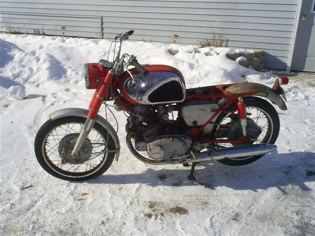

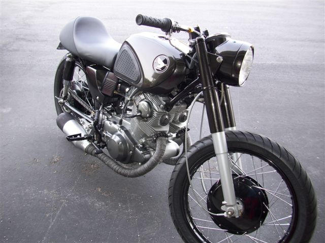

Here it is when I got it back in Jan '09

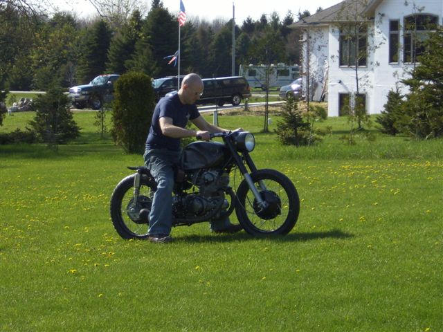

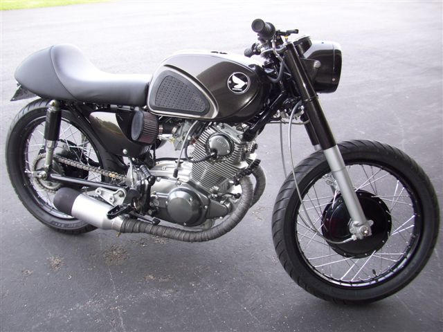

Here it is a couple of days ago, on my first trip to work, seat is still in process

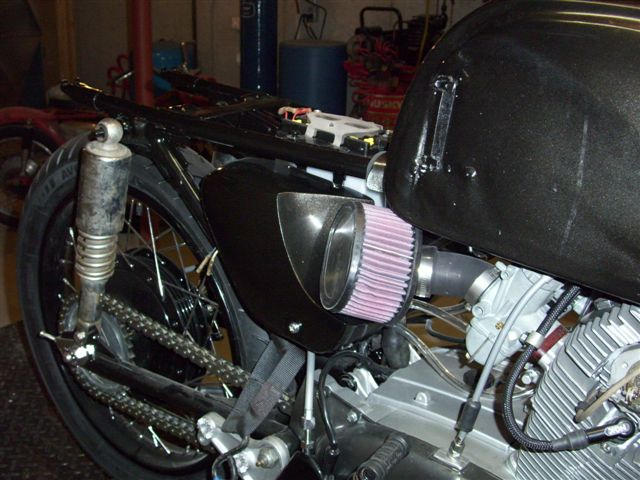

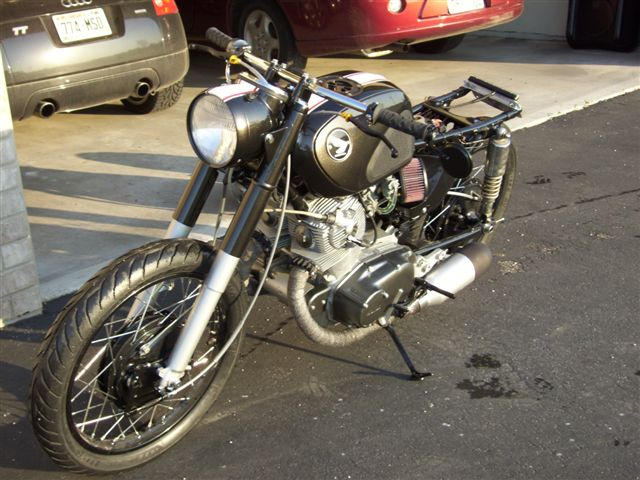

Quite the project you have there. What kind of air filters do you have on?
P.S. Looks like your badges are on backwards ; )

They are K&N (p/n 40-8455) I used the stock air filter tubes and had to cut the side panels so they would fit. They seem to work well. Jetting isn't stock though with the larger open filters and shortened Harley Street Rod mufflers.
Thanks for the catch on the badges! I'll get them switched around tonight.

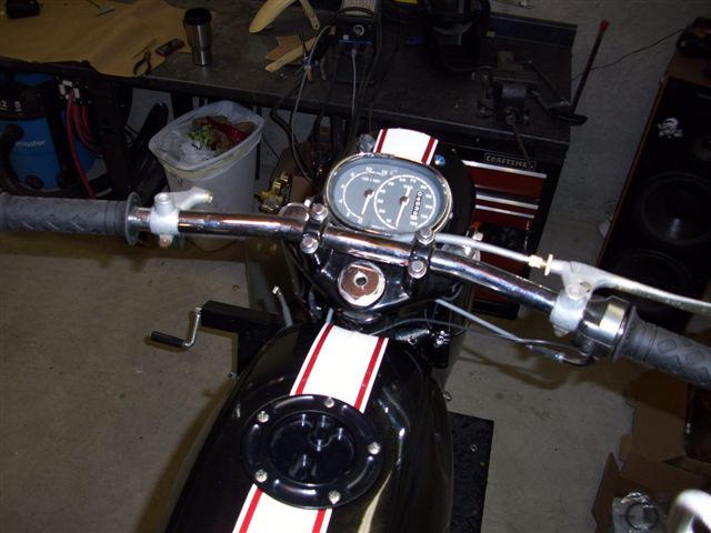

Finished Gas Cap (and yes it is vented!)

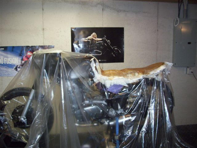

Building the seat pan, hopefully I'll have a completed seat by next week

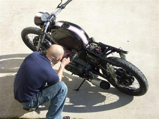

Trying to get the jetting dialed in

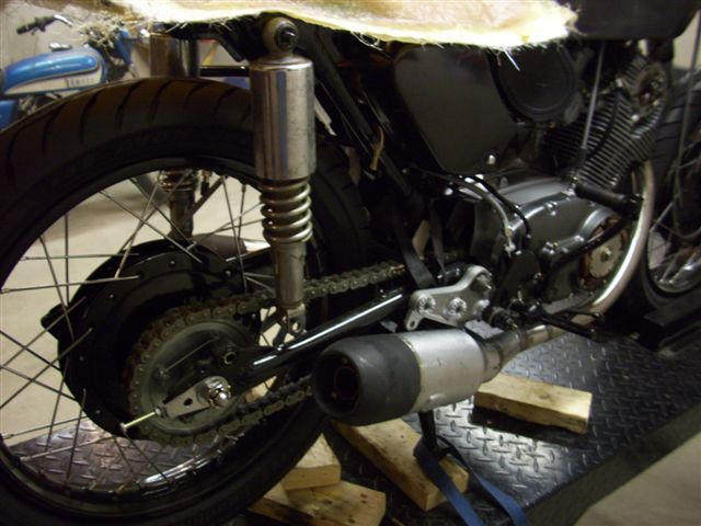

Are those cb350 shocks?
Post by Kirk » Fri May 15, 2009 11:19 am
Love the black rims and hubs are they powder or paint and are those CB350 Shocks?
I also did not see a fender brace on the forks, you may want to add one, (just my two cents)

The rims and hubs are powder coated. I wanted them to be a little tougher than just paint, most everything else is paint though. The tank is actually painted with Duplicolor spray cans. It looks pretty nice (doesn't show up in the pictures very well though). Unfortunately the spray bomb paint isn't very resistant to gasoline so you have to be extremely careful when putting gas in.
Honestly i'm not sure what those shocks are from. My dad has had them lying around the shop for years, they are 12.5" long and I thought CB350 shocks were longer than that (but I could be wrong). I still plan on tearing them apart cleaning and painting em. i've thought about making a fork brace for it but just hasn't happened yet.

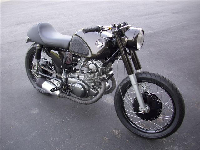

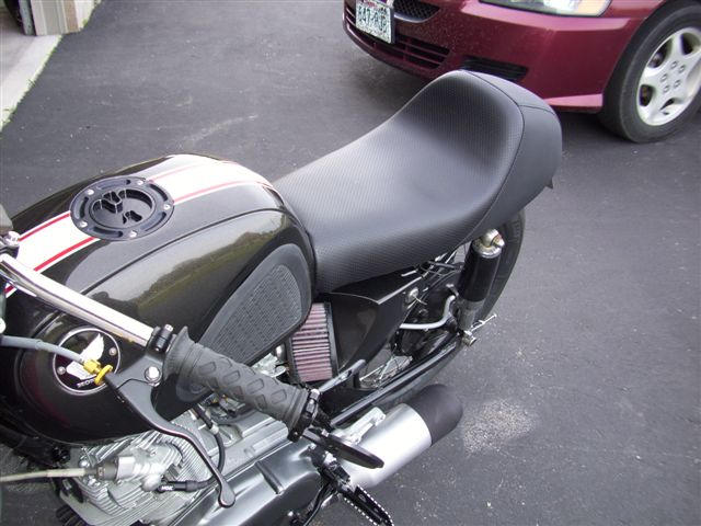

Here it is with the completed seat
Post by stout » Tue May 19, 2009 12:48 pm
Just got the seat finished up yesterday. the old shocks are back on there again until the paint on the other one's is dry.
