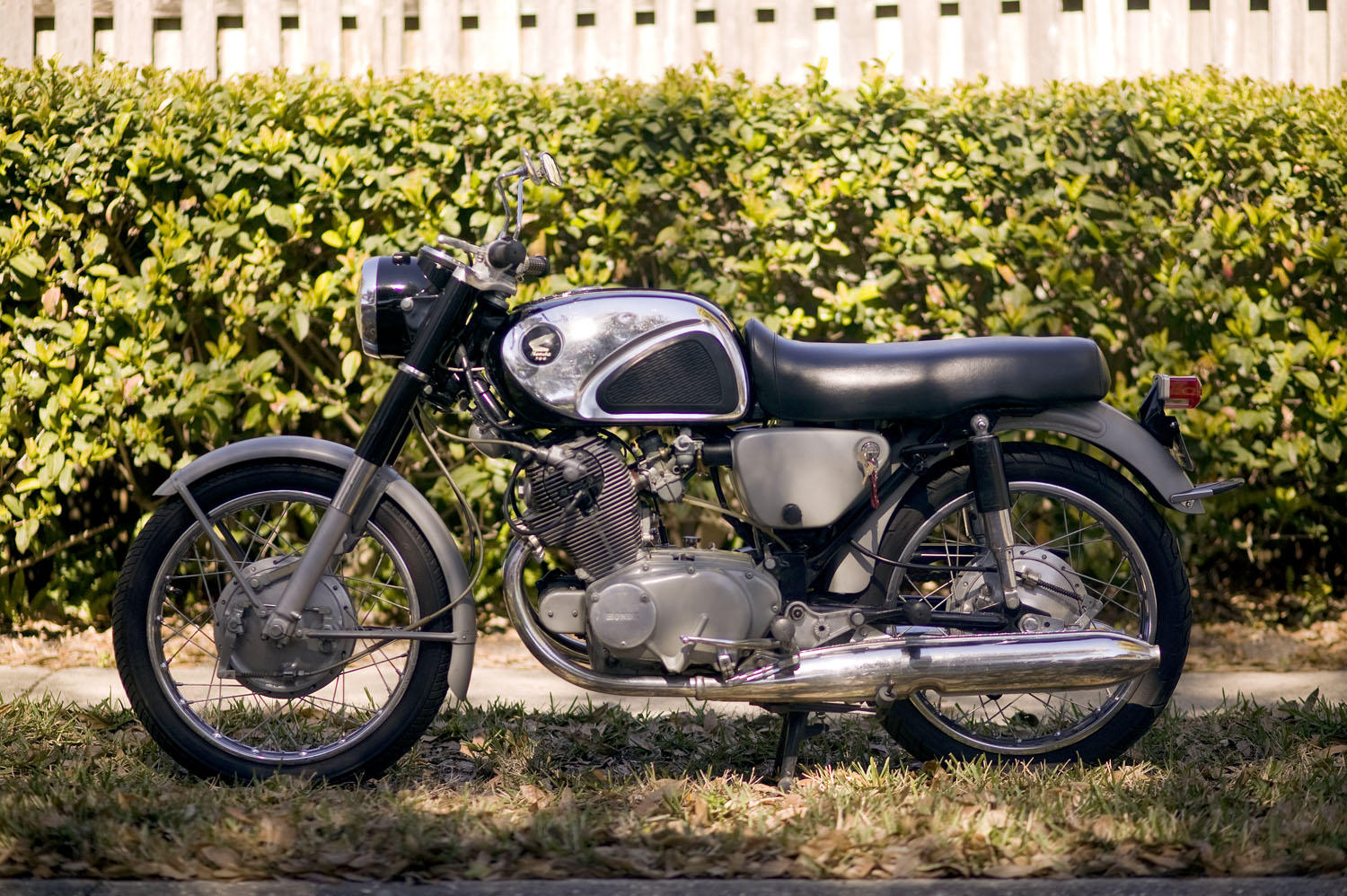

Here's my little gal...
BTW, I drove all the way from PA to South Bend, IN for this and 2 Dreams about 3 years ago!!!
Some guy was selling a huge collection of goldwings and the old 305 stuff was still left!!! So I took em home;-)

Nice looking bike. What are the air hoses doing that normally connect to the air filters?
vanquire wrote:Here's my little gal...

Hey thanks guys - the air hoses are connected to the air filters. The white-ish tubing in the pic is the carb overflows...

Another beautiful shot. What are you shooting with? I could be wrong in a particular instance, but from what I understand I don't think you're suppose to attach any hoses to the carb overflows on the Superhawks. I remember the resident expert LoundMouse having a discussion with a member who insisted they belong there because that's how the dealer gave him the bike. I couldn't find that thread, but he does state here that the CB77's should not have a tube covering the overflow vent.
P.S. What kind of tires do you have on there?vanquire wrote:Hey thanks guys - the air hoses are connected to the air filters. The white-ish tubing in the pic is the carb overflows...
