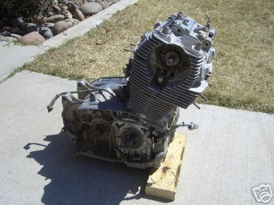

I'm in the middle of trying to find a replacement engine for my Type 1 CB77. I found a CA77 near complete engine which some parts are usable (see pic. below). My question is: is CA77 (305 engine) the same as CB77 and is CA77 type 1 or Type 2? (I can not find the right side cover so I do not know if this is Type 1 or Type 2)
Please help!

Type II have the single point system I believe while the Type I has dual points/coils with a double lead single condensor.
