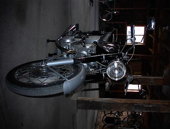

Here are a couple pictures of my restored bike. Don't jump me about the mix of late and early model parts. I put this together out of misc parts from my barn collection. I think she came out pretty well. I couldn't find a chain guard so I made one from sheet metal and painted it up to match.

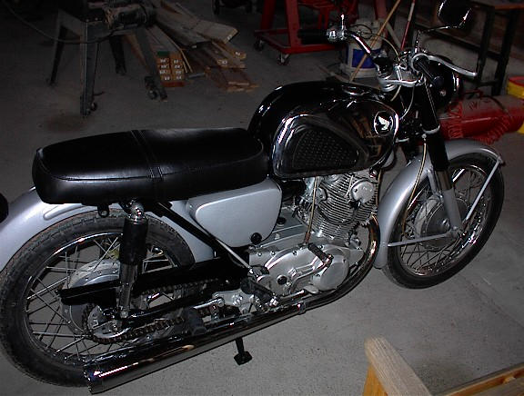

Another picture

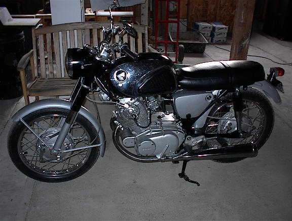

Final picture

Looks good man. The bike came out great.

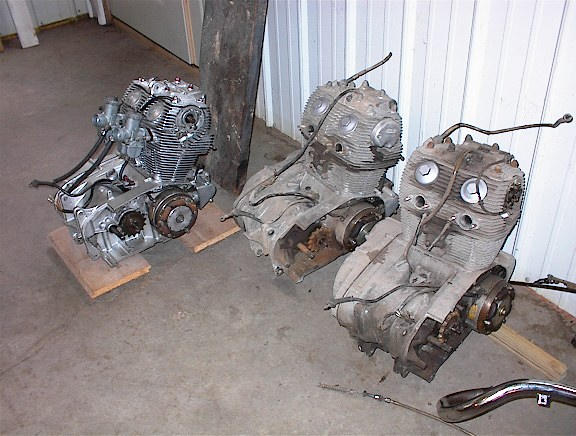

Kinda looks like my pile of locked up CB77 motors you have there... :)
