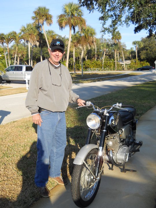

I like the look. Very racey. How do they handle? From the looks of the bike, you could take her around some nice corners!bikedoctor99 wrote:Here are a couple of pictures taken today and a few days ago. BTW this is the seat that I will make a cover for. Also a rear shot of the pipes you like.

these tires are great- big foot print so lots of rubber for braking and plenty of lean angle. They're very stable over the unexpected and unavoidable rough/ choppy surfaces and no problems with elongated deteriorated seams that I've encountered. Truth is, I've only ridden on OEM tires during the '60s. The tires that were used when I last raced this bike in 1970 were Dunlop KR73 Triangulars on 19" rims because 18" racing rubber wasn't available. I took the entire bike apart at the end of 1970 season for a total rebuild and the parts never saw each other again until last year; so this is the 2nd pair of tires for this bike. BTW  bike handles fine, need to turn the front hub and match the shoes while they're mounted to the brake plate. Can't remember who made the stacks, bought them in '67, but you should find bell mouthed types without screens- they will increase the intake air speed. The pipes are the same ones that were available as a kit with your seat!
