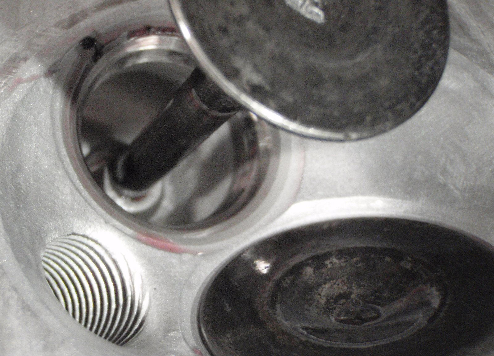

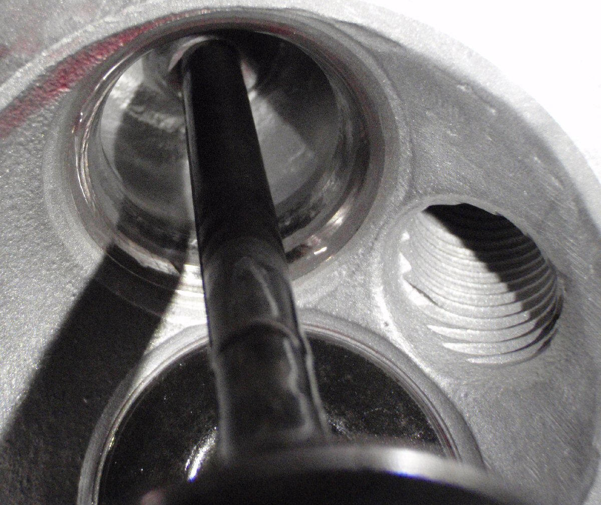

Be careful to copy the specifications from the manual, it's written in the old days, when leaded fuel was the way to go. Nowadays, there is no lead in fuel any more, and that has influence on the way how to machine the valves. and seats. I experimented a bit with the contact area, and found a by a specialist suggested 1 mm to 1.5 mm contact area working good.
The pictures are taken from my CB400F '75 head, which received a nice valve job.
I use the same area's on the CB72 / 77 heads, but this was easy to picture, because it was on my desk.
Jensen
