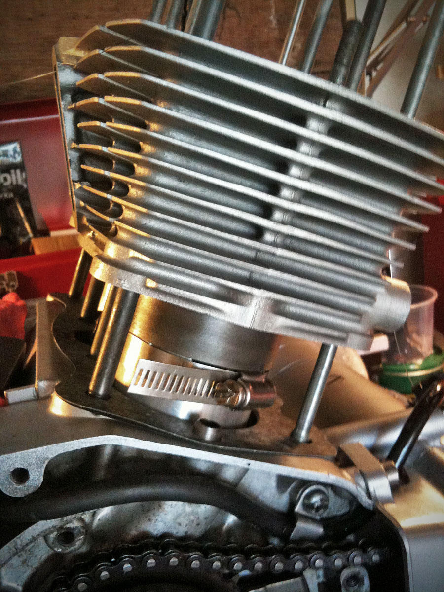

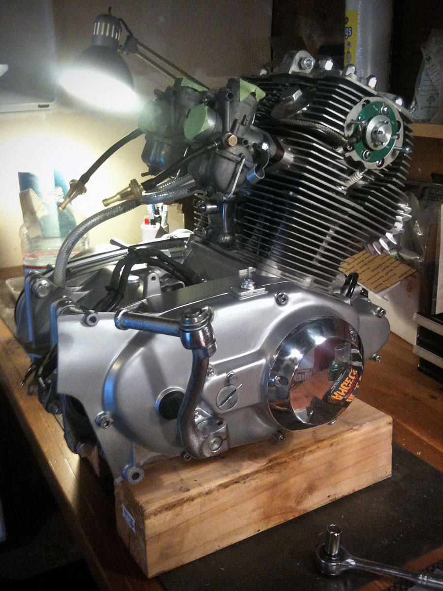

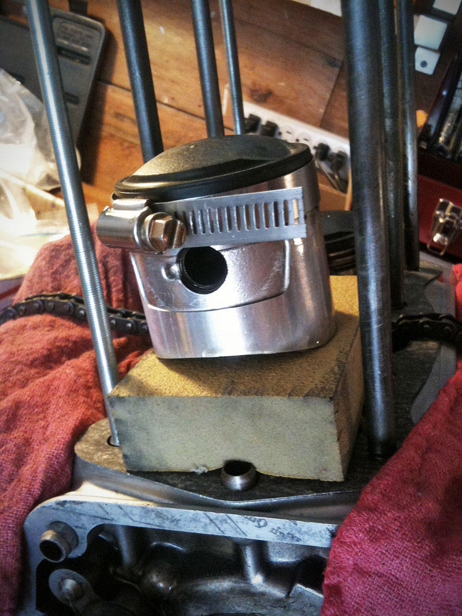

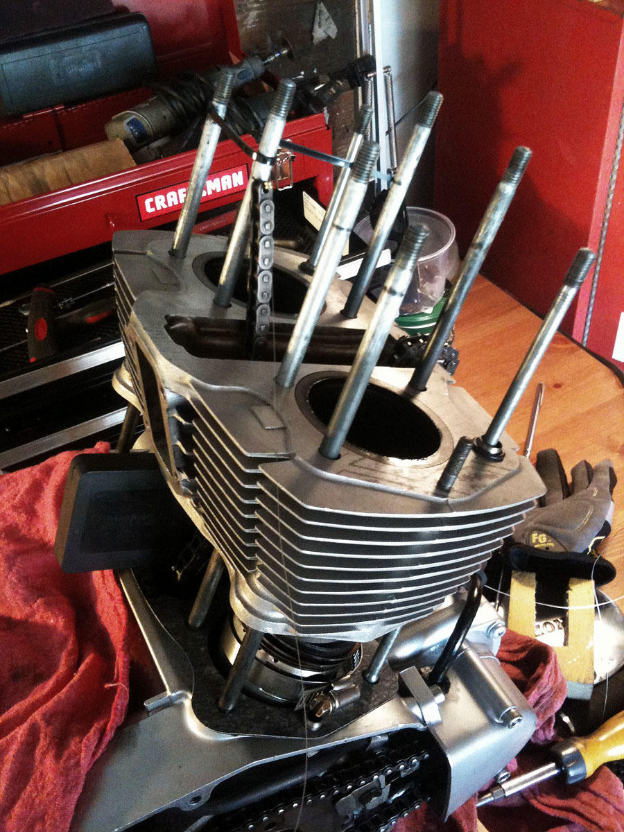

Sorry for the delay in updates. I got the engine all reassembled a while ago. Had to rely on my cellphone for grabbing those shots.
I took a sanding pad a cut a nook out to help brace the piston when lowering the cylinders on. I used a hose clap as a makeshift piston ring compressor. I wouldn't say it worked perfectly, but made the whole process pretty simple when doing it by yourself. Running the cam chain was the usual puppetry act of wires, but also went without a hitch for the most part.

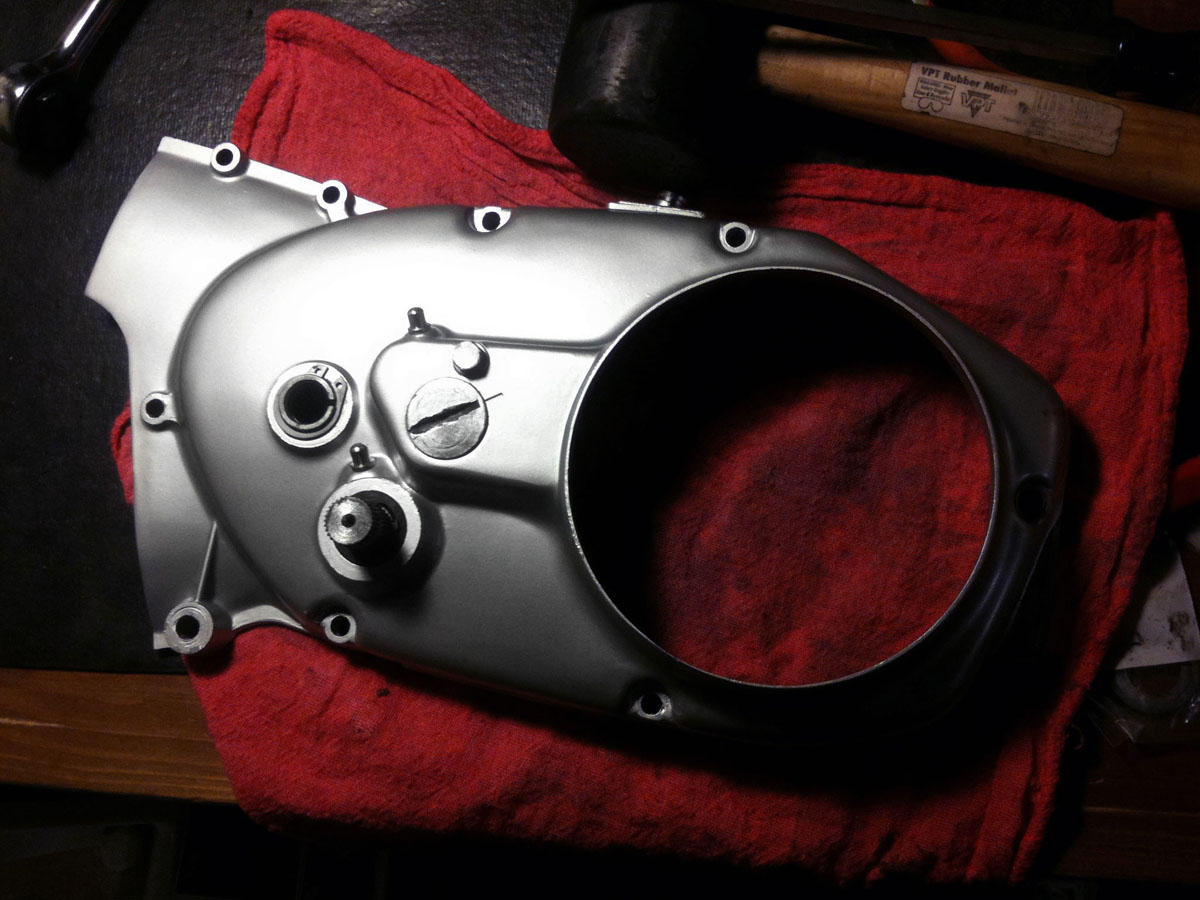

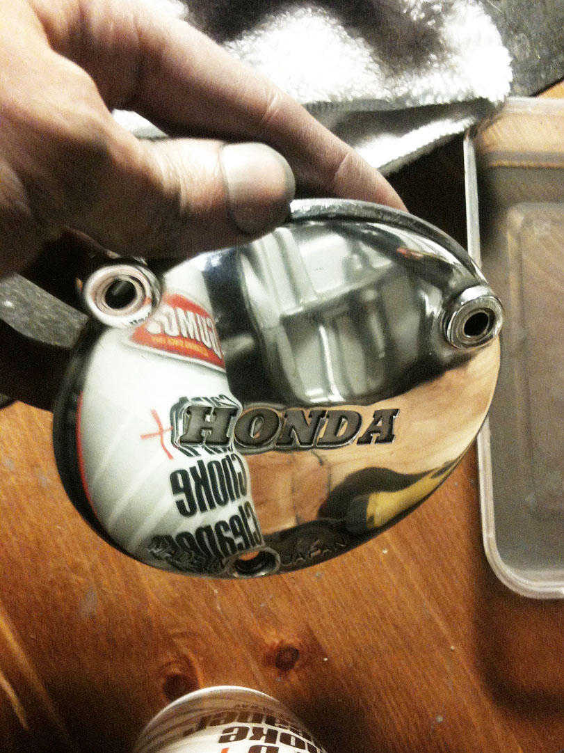

Post by Spargett » Fri Apr 02, 2010 11:16 pm

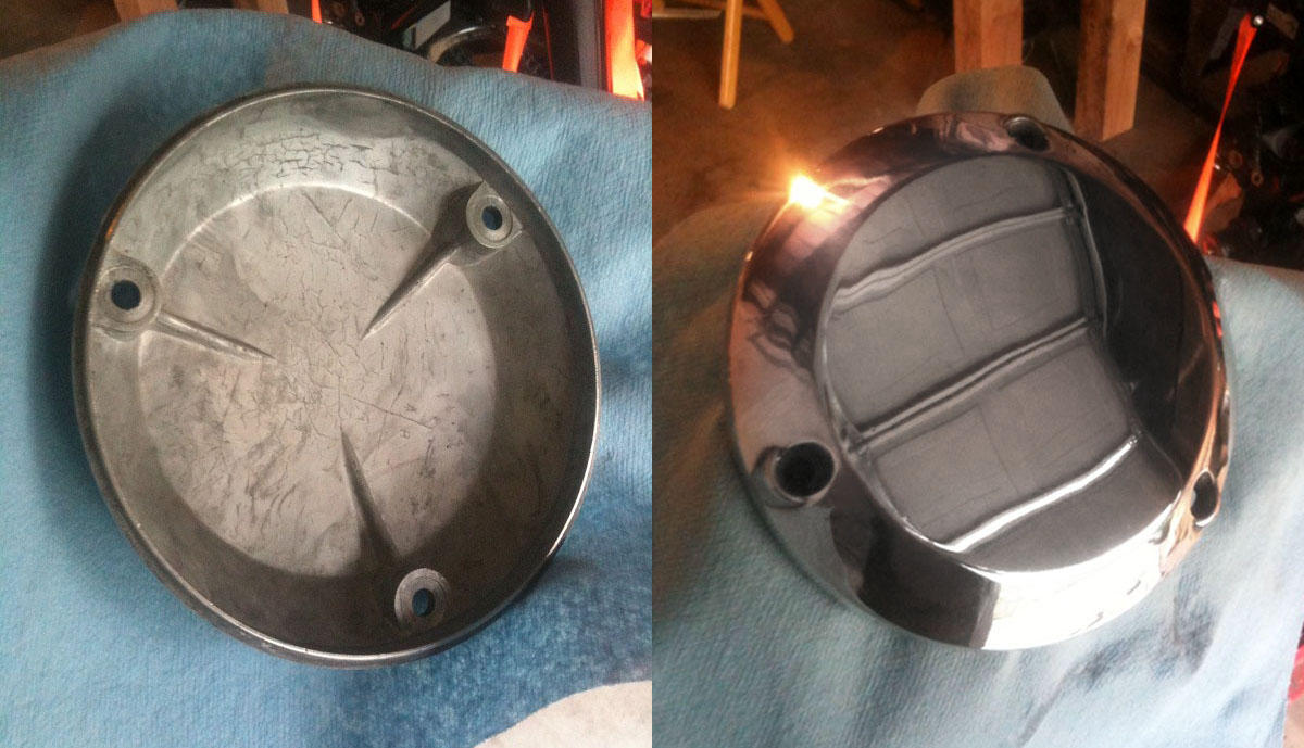

Got some good results polishing. Of course this took hours of sanding first, some of these 'new' aluminum parts were in rough shape with some deep nicks, oxidation, or scratches.
The oil filter was powder coated black and had deep gouges running from the bottom to half way up from what I assume was caused by it's weight falling on a shift lever. The stator cover looked about the same on the front as it does in back.

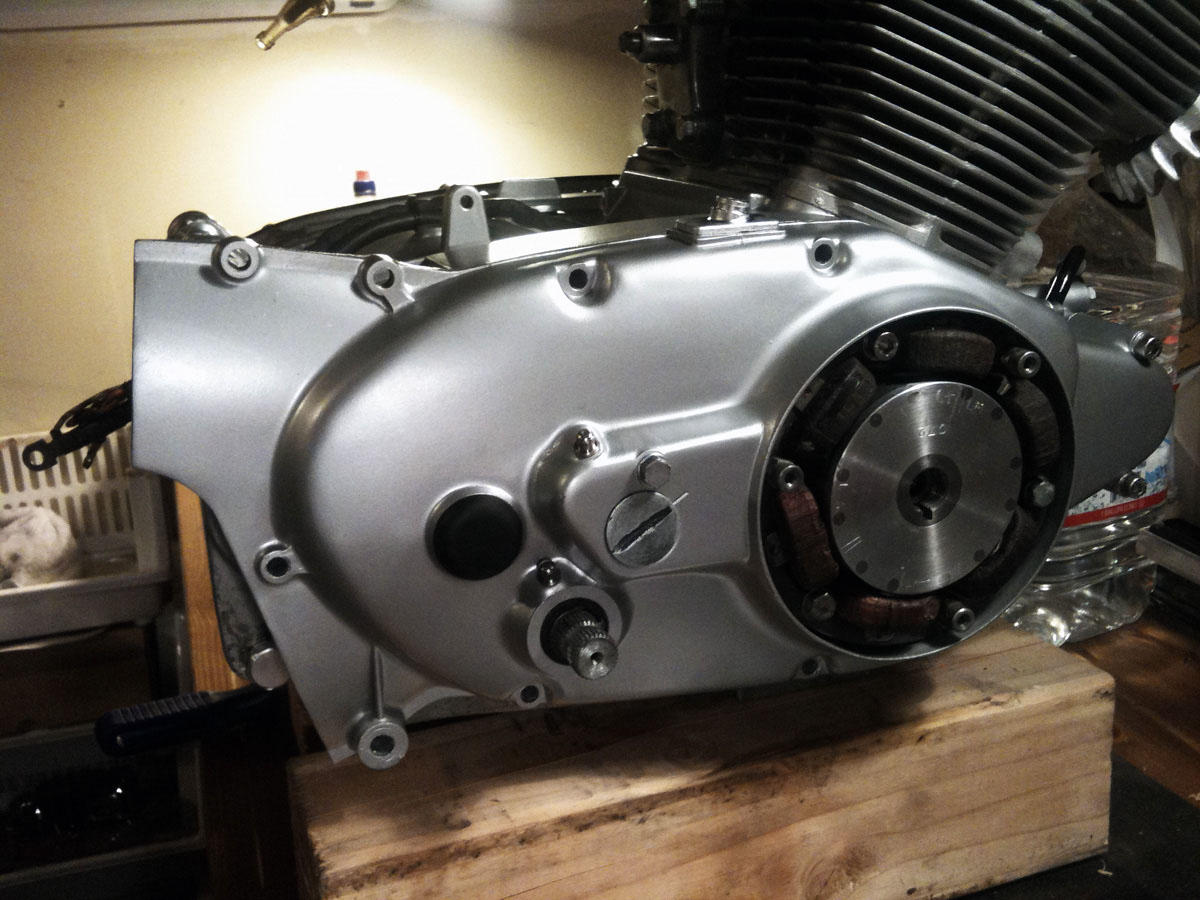

Post by Spargett » Fri Apr 02, 2010 11:23 pm

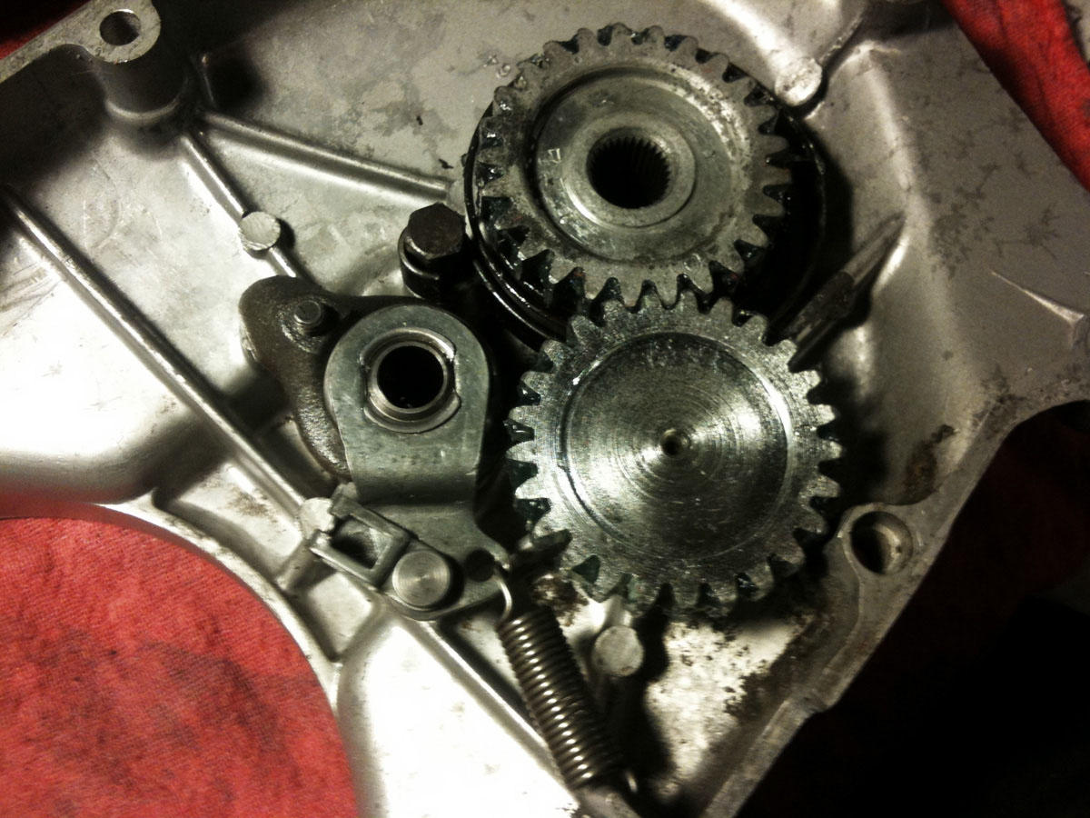

Brought two crankcases back to life after sanding, priming, and painting. Finally have a proper CB kickstart assembly. A chromed (some people) CL, right side crankcase came with the bike. Between three different crankcases I had, I was able to assemble a nice example of it should be.
I used Bel Ray waterproof assembly grease on the kickstart gears. This stuff stays put as a solid jelly, which will keep the insides much cleaner. Standard assembly grease was used for the rest of the internals.
The clutch adjuster took a fair amount of time with a file to get it to fit right right, but now it moves smoothly and holds it's place.
