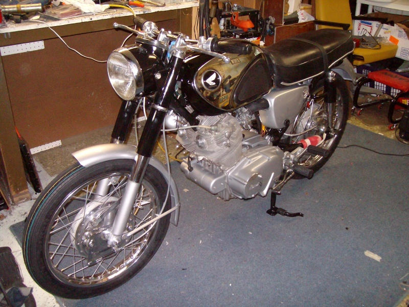

This week I finished up the wiring and tested it with the battery charger. Everything is working. Then we worked on the right side. We put on the chain, chain cover, clutch cable, and side cover. Next the linkage and pedals. Lee was right about putting the chain cover on first. The screw on the back is a bugger to get on with the wheel on.
Today we put the carbs on and the chrome on the tank. Retro bikes said they would have some rear brake cables in 3 to 4 weeks, so I wrapped the old one with some duct tape so it wouldn't scratch anything, and put it on until I can get a new one. We couldn't resist just dressing it up for a picture.
Gunner
