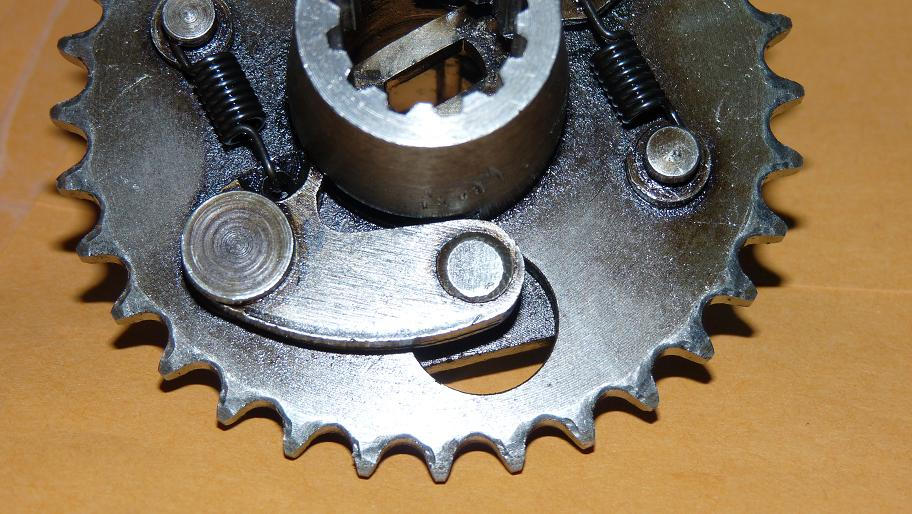

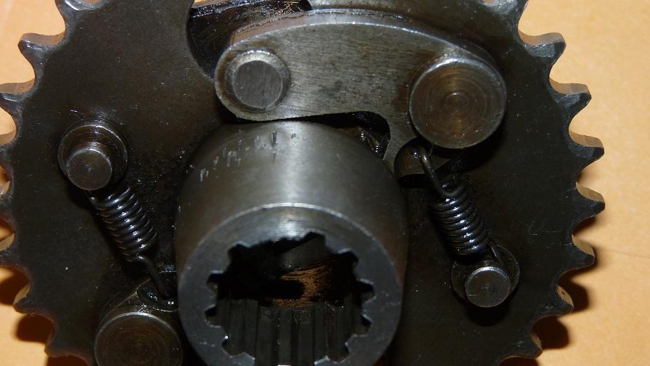

Here are a couple of pics that you ask for.
Ya ever going to answer my question about your statement I ask twice for an explanation of?. ..........lm
teazer wrote:I recently built a motor that Clunked as you describe it, but had tight springs, no perceptible lash and was silent when I ran the motor. No Clack-Clack at all when it ran.
Do you have a picture of a bad one (like Scott's perhaps) so we can see the difference? Or am I to understand that it'snot so easy to spot visually.
Weight laying on the center part.

Thanks for those pics. It's not all that obvious to an untrained eye, but if I understand the comments, if the weight clunk down onto the steel center part it's going to be noisy in all probability, and if the weights are "off" the center part and have some rubber still on them, it will probably be OK. Cool. I'll try to remember that.

So it looks like the neoprene in this one is doing it's job by keeping the weight just barely off the center. Maybe a millimeter or less, correct?

That's how I'm interpreting the info from Ed (LM)
Post by LOUD MOUSE » Thu Mar 04, 2010 8:26 am
You are correct Scott ..lm
Spargett wrote:So it looks like the neoprene in this one is doing it's job by keeping the weight just barely off the center. Maybe a millimeter or less, correct?

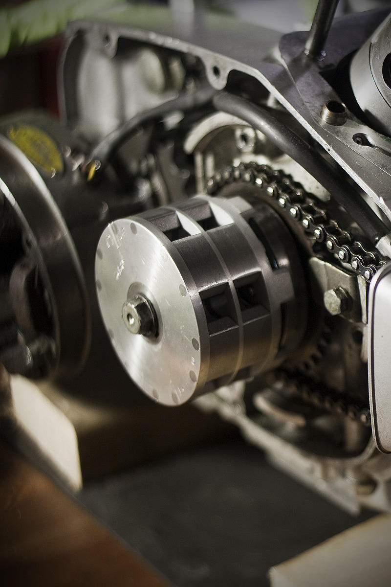

The cam sprocket Loud Mouse sent me along side the old one. You can see different height gaps where the advance weights "contact" the center. The old one was sitting right against it *clack*, where the new one has about 1mm of space. The sprocket has also been tac welded into place to avoid any possibility of the rivets loosening over time. (click to view larger)
Installation of the cam sprocket; tightening the locking nut down.

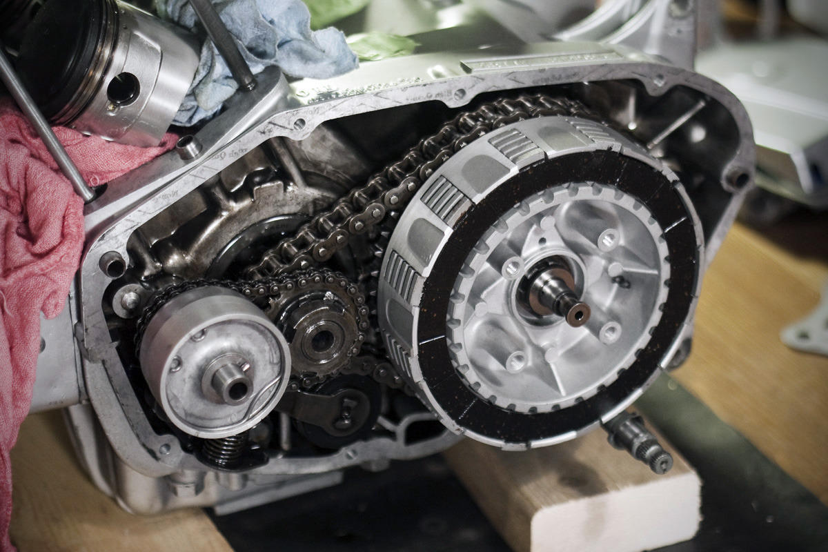

Attached are a few other photos of the new cush drive clutch he rigged up and mailed for me as well as my original (stronger C72) rotor cleaned up with the LT/LF stamped in now. I'm working on tons of different little things in getting the bike back together right now. I'll be reassembling the top end tomorrow and installing back onto the lower end.
New clutch
New clutch
Original (stronger C72) rotor cleaned up with the LT/LF stamped in
