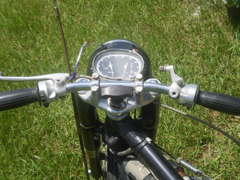

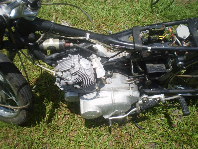

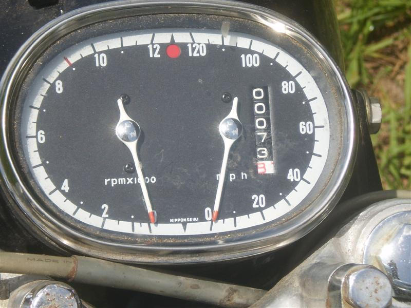

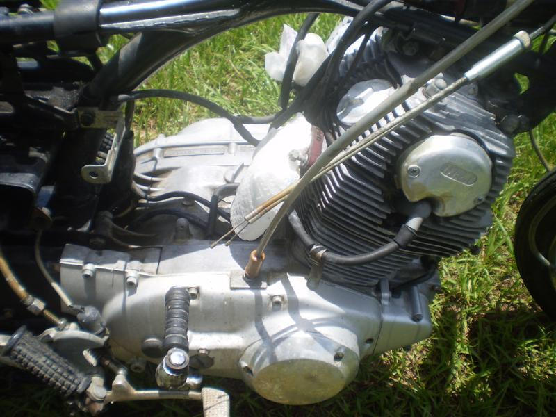

Ok went out last night and bout the oil I got the synthetic. Here are couple pics of the bike as of now. I am waiting on the new air filters and the tank cleaner and sealer to get here as long with the exhaust flanges and collars also the new battery.
All thats left to do is take off the side covers on the motor and clean and paint them while they are off change the oil and degrease the motor and then paint the rear fender then clean the wheels. Then put it the fenders and stuff back on and let it ride.
