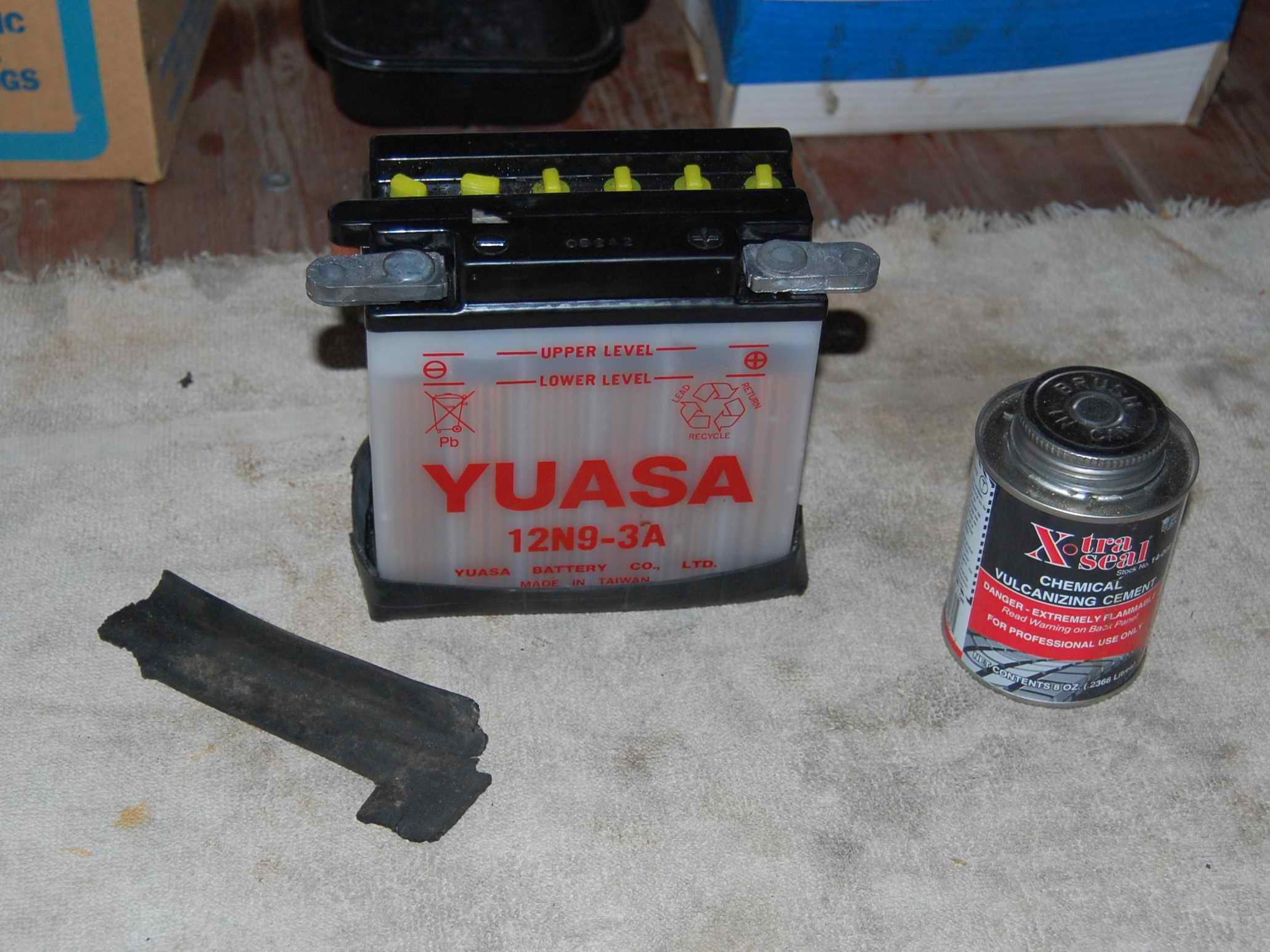

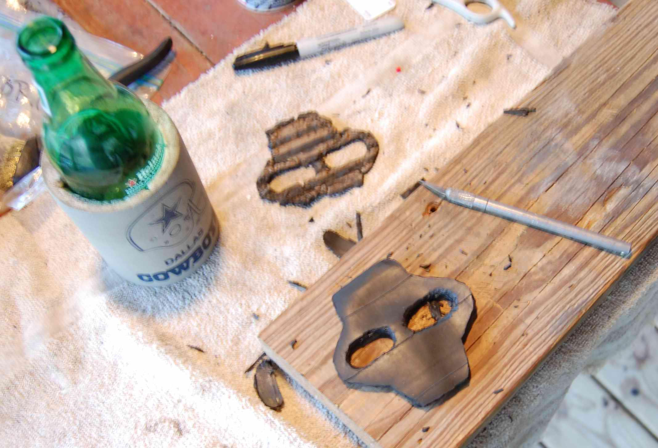

Do great minds think alike or what? Look what I made at end of yesterday. Mine's a bit cruder and thicker than yours, several layers of tube laminated with vulcanizing cement to try and match thickness of original, cut freehand using old piece as a pattern. I got it too thick, will need to peel off a couple of layers, but cement's not stuck that tight so oughta work.
Pad under battery was a shallow rubber box a little wider and longer than battery with sides about 1/2" tall. So gotta make one of those too, I've got one rotten corner of old one to go by.
I'm really enjoying piddling with these little details, taking my time, learning to be patient. There's a great temptation to just slap it back together and get back to details later, but I know me and it might take forever to get back to little picky stuff if I don't do it now. --Lee

Pic is my version of lower battery pad. I think I need to glue on a narrow strip around the outside to finish it off. As you can see from fragment of old one, it had a rectangular cutout in bottom (for ventilation or drainage?) so I cut the bottom out of mine, too.
Enjoying watching your progress. Thanks, Lee
Somebody who knows more than me could maybe tell you if your old rims would be worth anything to someone who wanted to clean up and have rechromed. I've seen some pretty gnarly ones on ebay, somebody may want them.
