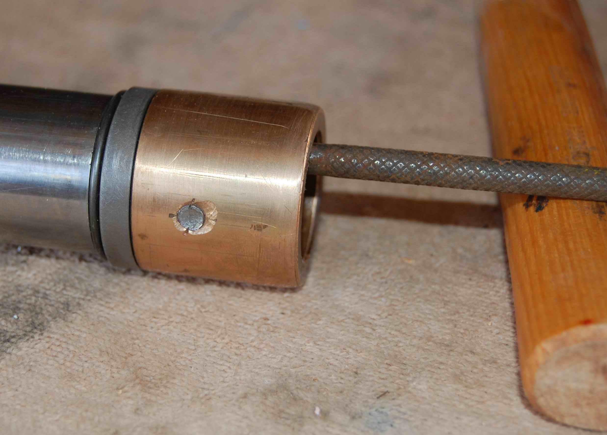

I'm new to this forum, but it just happens that I'm replacing the fork seals on my 1963 CB77. I want to thank you for your excellent photos on your restoration--they have been very helpful to me as I try to put the life back into my machine.
Just the other day my right front fork assembly, which has been off the bike for a month or so, decided to disassemble itself when I lifted it up by the top. I was quite surprised to find a 10 inch long fir splinter resting in the lower case. At the same time I was very pleased to see exactly what the fork innards look like, as I have yet to come across a useful diagram/explanation for fork disassembly and seal replacement.
Given my very limited knowledge with the CB77, I offer the following:
Once the chrome fork seal housing has been unthreaded from the lower fork case (use a strap wrench or other suitable tool), the lower case should separate from the upper, thus exposing the spring and other innards. From my photo you may be able to see that removing the 3 spring clips will allow you to slide the piston, damper valve and fork tube guide off from the fork tube. You can then slide the chrome fork seal housing down and off the tube.
Removing the fork seal is not all that much of a hassle. I used needle nosed pliers to pull out the seal retainer clip and then I used a hammer and screwdriver to gently beat on the seal perimeter from the narrow end of the chrome housing. It took a little while, but by working around the perimeter, it slowly loosened and came free. I did this only this afternoon, so I have as yet to discover the intricacies of installing the new seal!
I hope my photo uploads ok, and again, I compliment you on your very illuminating documentation.
Wilf

Wilf, connection of your piston to tube is quite different from my early 62 model which used three tapered "knock pins" to hold the piston on. These have to be knocked out from inside the tube to get piston off, a bit of a challenge. Glad I had expert help. Good luck with the rest of the job. Post some pix?
