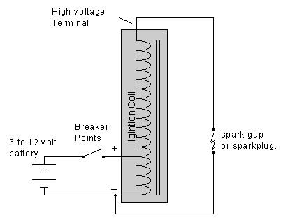

First & foremost, my apologies for not realising that you're working on a CA; I read Rob's (Snakeoil's) response and thought you'd picked up a CB project as well as your bikes annotated in your forum signature. In view of the now-clearer facts, please disregard my previous post's procedures. But, more importantly, you should still correct the polarity of your ignition coil's LT circuit -- see schematic drawings below. As Ed would have explained, I'm sure, the High Tension circuit is of greater importance for a good & healthy Big Fat Spark, so close attention to the requirement for good copper HT cable is paramount, along with the plug cap as well, although the 10k-ohm resistance is purely to suppress stray Radio Frequency interference. Great news that your starting problem is resolved!
