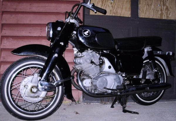

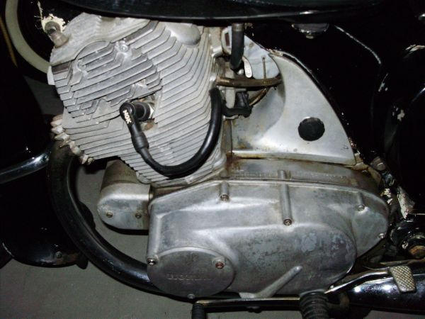

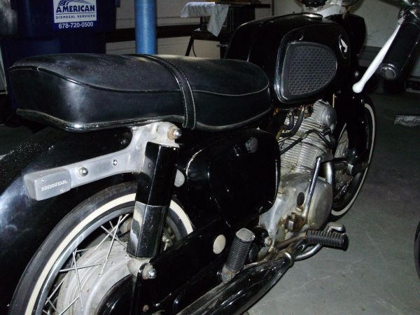

Hello all.
I have a 64 Dream 305, it ras running only on the right side, I flipped plugs, still only right side, I crossed the wires, still only right side...
so, like a fool, I tried cleaning the points on the right side, now neither side fires....
are there points on both sides ? ugh...
-should I just buy nos points ?
thanks in advance-
D
I am in the North Atlanta area, and willing to sell it, clear title...
