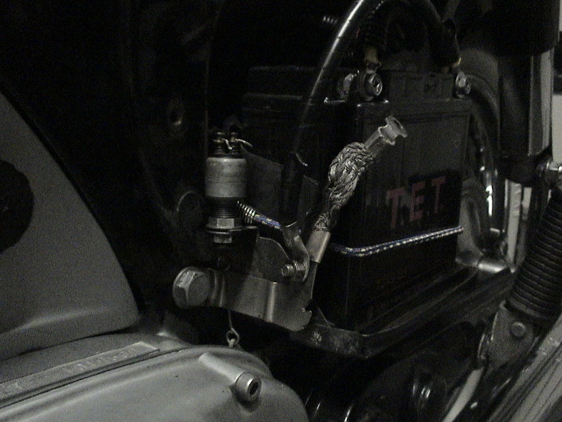

Post by brewsky » Wed Dec 01, 2010 7:46 pm
Here's a pic of the battery ground strap mounting location.
Pay no attention to the extra black wire attached to the middle...my battery has the poles reversed from where they are supposed to be, and I had to run the ground wire all the way across to the back end of the battery.
