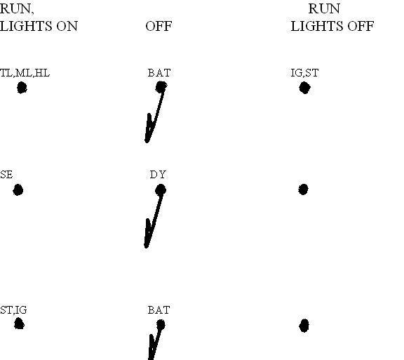

Post by brewsky » Wed Nov 17, 2010 7:24 pm
This is about the best I can come up with for a replacement switch design.
A triple pole, double throw or
A double pole, double throw combined with a single pole, double throw
with center off position? (15 amp)

Post by e3steve » Thu Nov 18, 2010 7:57 am
That works Brew. The only alternative would be a DPDT with centre-off and a SPST 15A (contacts) relay; the relay contacts to link the pink & yellow when the relay is actuated. Coil connections across ground & TL,ML,HL junction (RUN, LIGHTS ON).
