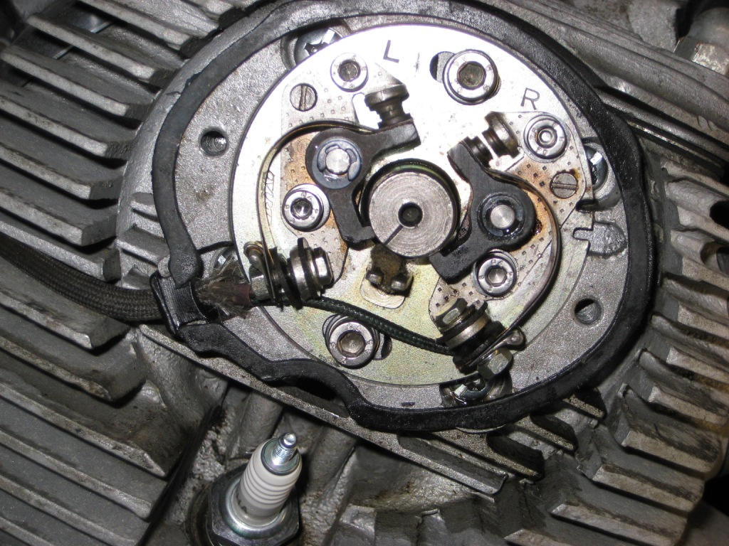

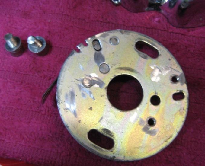

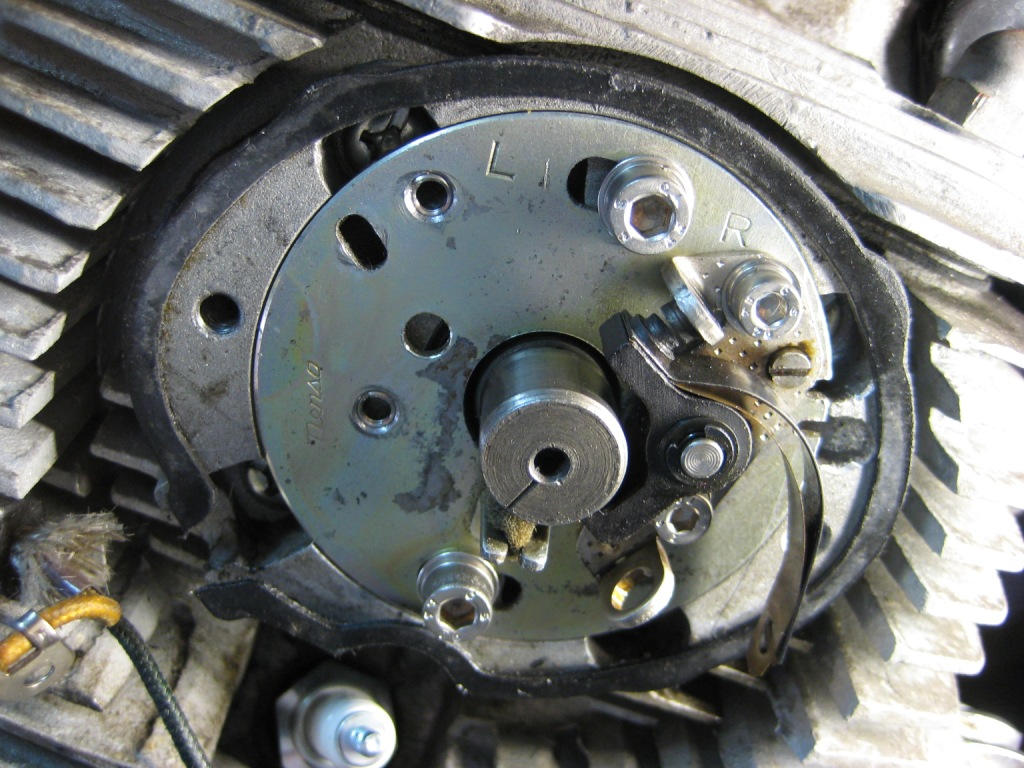

I pulled my points' plate off today (it's raining!) to mop some oil mist away and to replace the main screws. I was going to Recoil the threads, in the right-side casting, with M5 inserts, but those threads are already that thread (and they've not been fitted with re-thread inserts). Now, this is odd, as I was under the impression that 5mm and smaller were all JIS; my M5 screws went all the way in without any binding.
The plate re-threads are M4 -- and the Allen key is 3mm (not 2.5 as I thought yesterday).
Anyway, FYI, images below.
