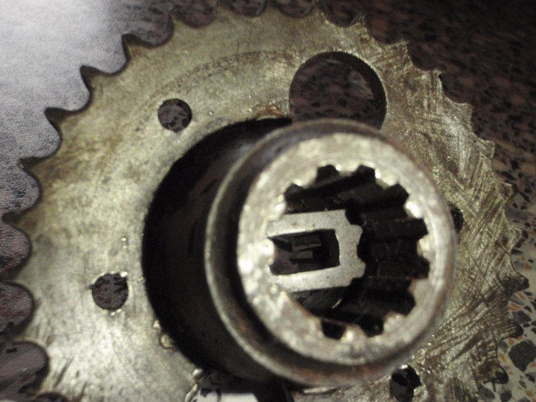

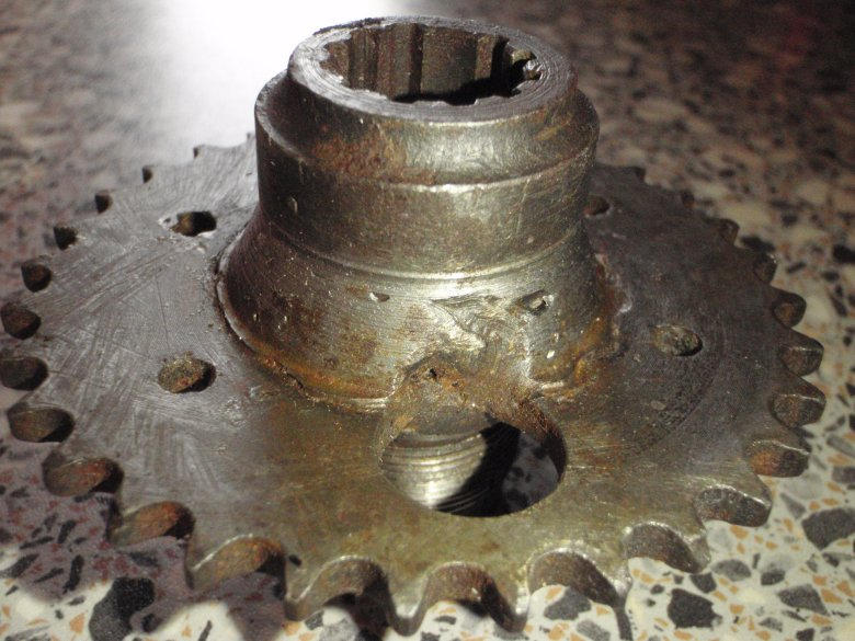

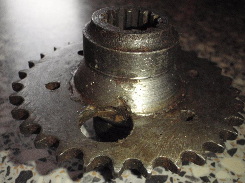

If you like, you can try this one, it's welded by me, because the advance mechanism was beyond repair. I tested it my engine, with the verdict and results mentioned earlier.
