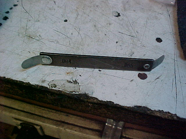

Finally had a chance to take a stab at the seemingly "easy" task of valve adjustment. In my case, it involves removing the tank-which was a whole other hang up for me. (Ill save that knee-slapper for another time). Anyway, I assume the (.004) measurement I am taking, is the gap between the valve adjuster and the top of the valve. Where the adjuster makes contact with the valve, is down in a recessed well. Do I need a narrower (than typical auto part store) feeler guage? Am I measuring the distance between the top of the valve and the adjuster, OR where the adjuster makes contact with the valve (down in the recession)?

If you trim a 1/4 inch off of the end of the wires as Ed suggested, you will be able to hold the wire, and screw the cap into it. Here's a pic of Motion Pros tool for valve clearance Most moto shops sell them, around $5, or check thier website. They aslo have a nice tool for removing rotors for $10

I have made something like you have in the pic. My qeustion for you is; what is the width (not thickness) of those end pieces?
