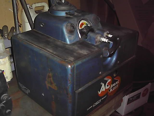

160 PSI? that sounds like a lot , how did you check that?

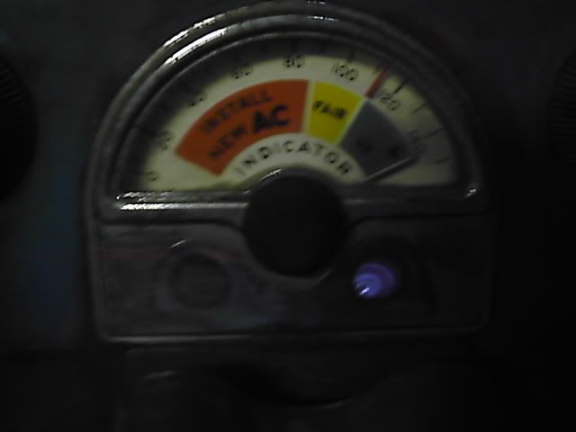

testing the spark with the plug out against the head doesn't always give you accurate results. i have had problems with new NGKs and always test them under pressure with my AC plug tester/cleaner before installing.
this is a new NGK DH8A firing great at a little over 110 PSI , the spark went out at 120 PSI
