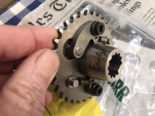

With the help of several on this forum, and using my timing light to observe dynamic ignition timing, I could see that when the static timing was right on, the max advance was about 11 degrees past the marks. This is caused by wear in the advance mechanism, in particular, the neoprene ring on the advance limiter pins were worn away. A member of this Forum, Tim Miller, has engineered a fix for this. About two weeks ago I sent my cam sprocket to him for repair. This was done in a few days for a very reasonable $125, and featured a rebuild of the old mechanism with improvements in several areas, especially a hardened steel replacement for the stock neoprene-covered advance limiter pin.

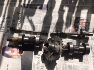

I’ll try to add photos of the bike near its breakdown spot, and the beautiful advance mechanism along with the world’s most complicated camshaft assembly.

Tim Miller
- Posts: 242
- Joined: Mon Jan 30, 2012 6:22 pm
- Location: Pflugerville, TX
Re: Engine seizure/advance repair
Thanks Larry!
I’ve been modifying these for 15+ years and it’s by far the best performance modification you can do.
It also fixes the loose rivets/gear problem.
When I first tried this I was concerned about excessive noise when the bob weight stops made contact with cam gear, but there’s no noise. I suppose Honda’s eager engineers back in the day though the rubber was necessary to keep the weights quiet or just not to bounce? but it’s not necessary, there’s no evidence of erratic timing visible with the strobe light and there’s no noise.

I admit I was surprised at the violence needed to remove the sprocket. I don't like hammering on ball bearings to remove them. There are 4 bearings supporting the cam, and for some the removal force is transferred through the balls, which I always thought was a no-no. My advice to others is to plan on replacing at least some of the bearings if you do this.
I may have been doing it wrong, but can see no way to avoid the hammering.
