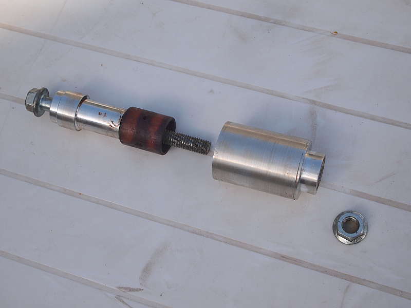

This is one I made for the front suspension fibre bush on Dreams. I made a similar one for the rubber bush.

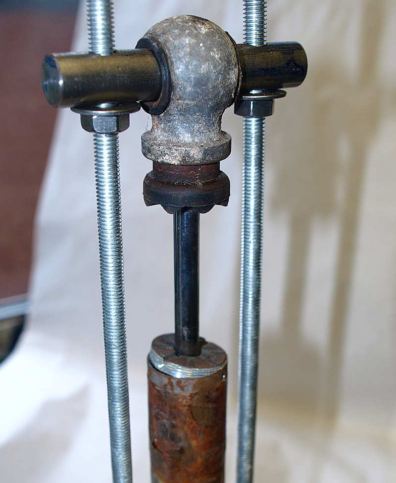

Undo the slotted cover, then pull the inner parts free from the body. They are pretty tight.
Once you have the damper internals out, you can either reuses as is or dismantle further to replace the seals.
