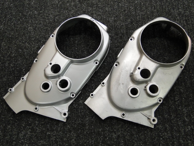

Hi - There's a lot of old posts in the "Paint" section, but I use VHT High Temperature Engine Enamel Universal Aluminum SP127. Its available from the Summitt Racing Website. Its a good match and its fuel resistant. You have to bake the parts at 200F for an hour, but you can use your kitchen oven after everyone goes to bed, and nobody will know - it doesn't smell. Attached is a pic of a side cover I painted next to a NOS piece. If you want a can to try, email me and I'll send you one (I bought a case last year and probably won't use it all). swmrescue@cox.net

48lesco wrote:Hi - There's a lot of old posts in the "Paint" section, but I use VHT High Temperature Engine Enamel Universal Aluminum SP127. Its available from the Summitt Racing Website. Its a good match and its fuel resistant. You have to bake the parts at 200F for an hour, but you can use your kitchen oven after everyone goes to bed, and nobody will know - it doesn't smell. Attached is a pic of a side cover I painted next to a NOS piece. If you want a can to try, email me and I'll send you one (I bought a case last year and probably won't use it all). swmrescue@cox.net
reply sent via email
