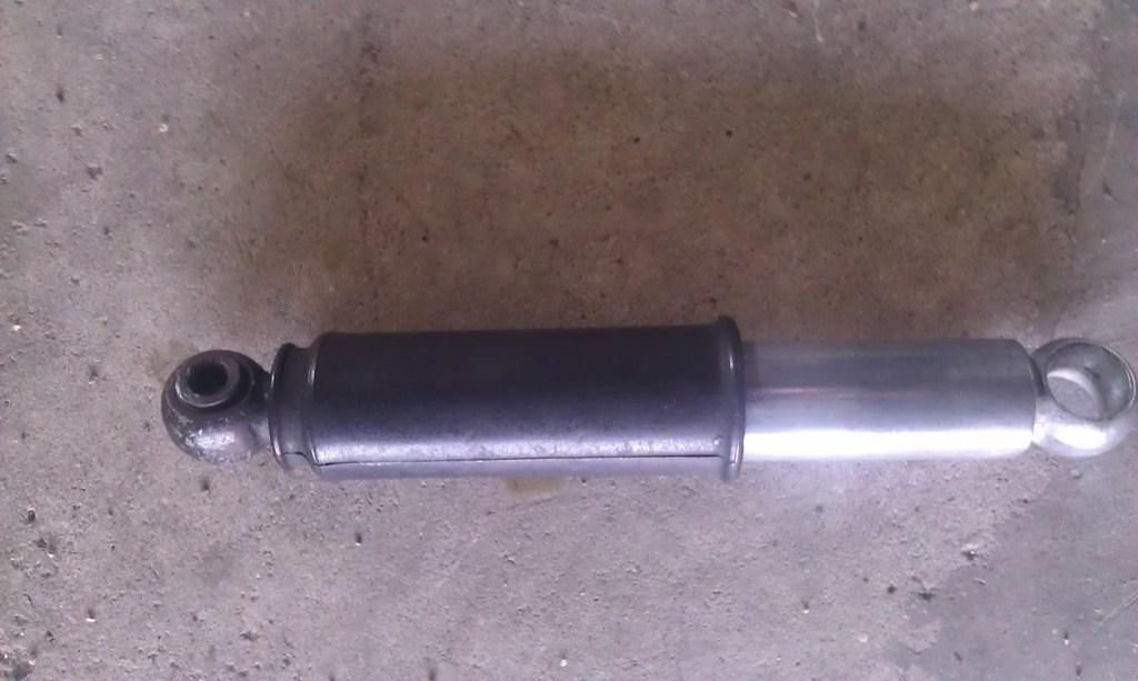

Does anyone know if the steering dampers come apart? I have two that need the rubber and actually there is someone that sells that part. However, not sure if it comes apart?

Yes, remove the rubber boot and there is a jam nut under the eye.
