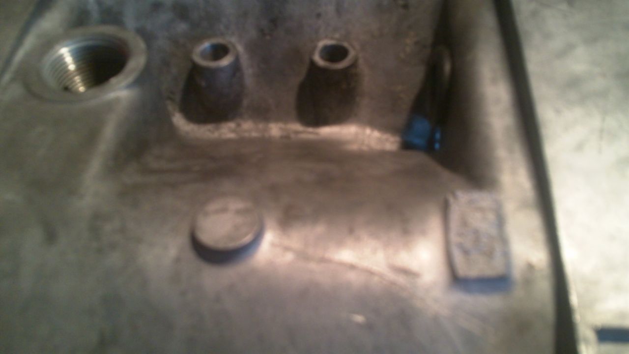

I completed my engine tear down and was soda blasting the upper case and after the layers of grease were gone I noticed something was missing/broken. An anchor or hanger is broken off. What is its purpose? Need a new upper case? Engine was in pieces when I received it.

The carb covers are connected together by a spring loaded knob and the left side locks into the right side. The right side also has a small screw to hold it in place. Don't know whether you can get by without it or not.
