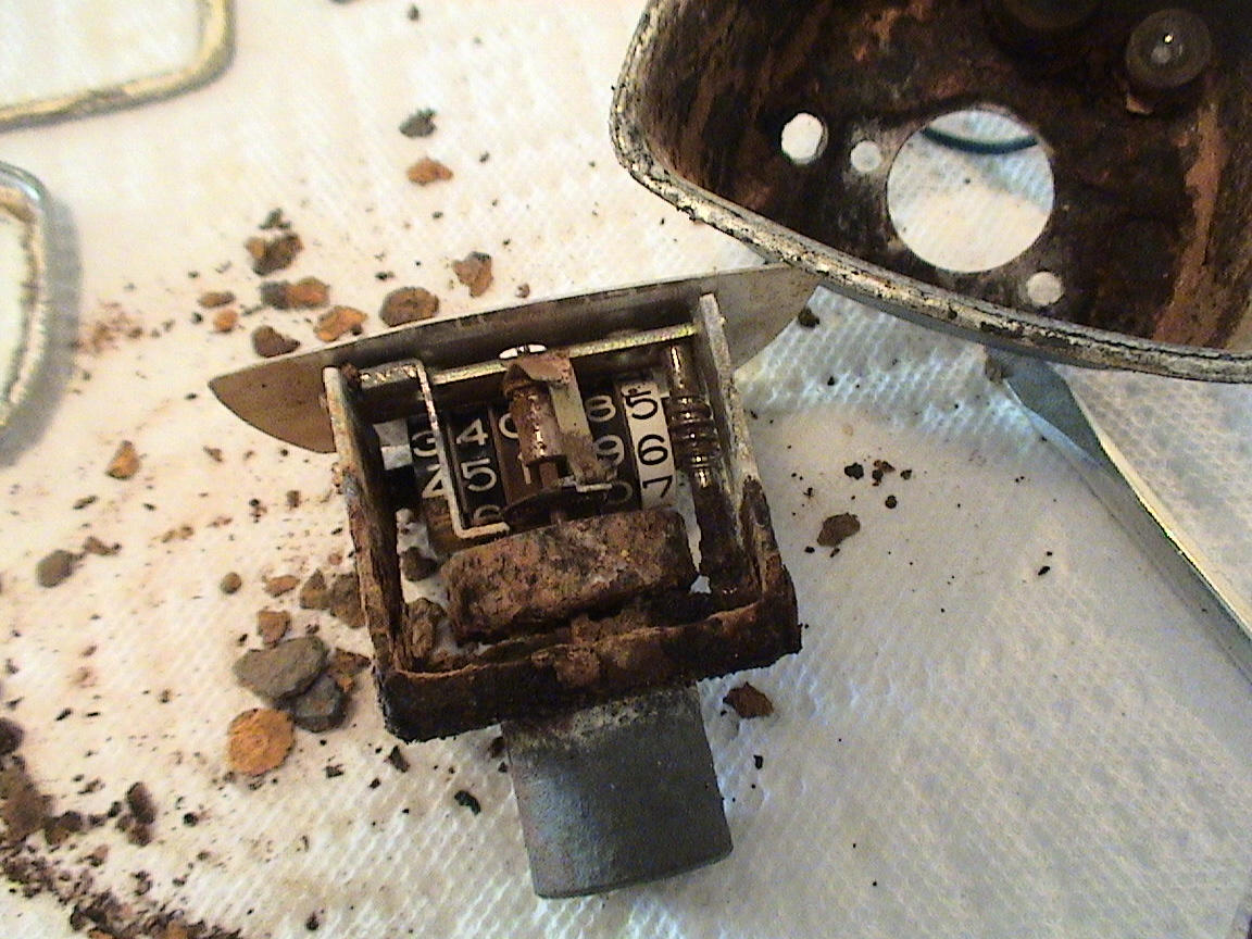

Post by brewsky » Thu Aug 12, 2010 6:54 pm
burvis wrote:Hi folks,
this topic is pretty well covered already. I thougt I had searched this before, apparently not. Looks like I need to lube and recondition my speedo works, and use white grease on any new (4th) cable I try.
It's not that hard to do....unless it looks like this.....
