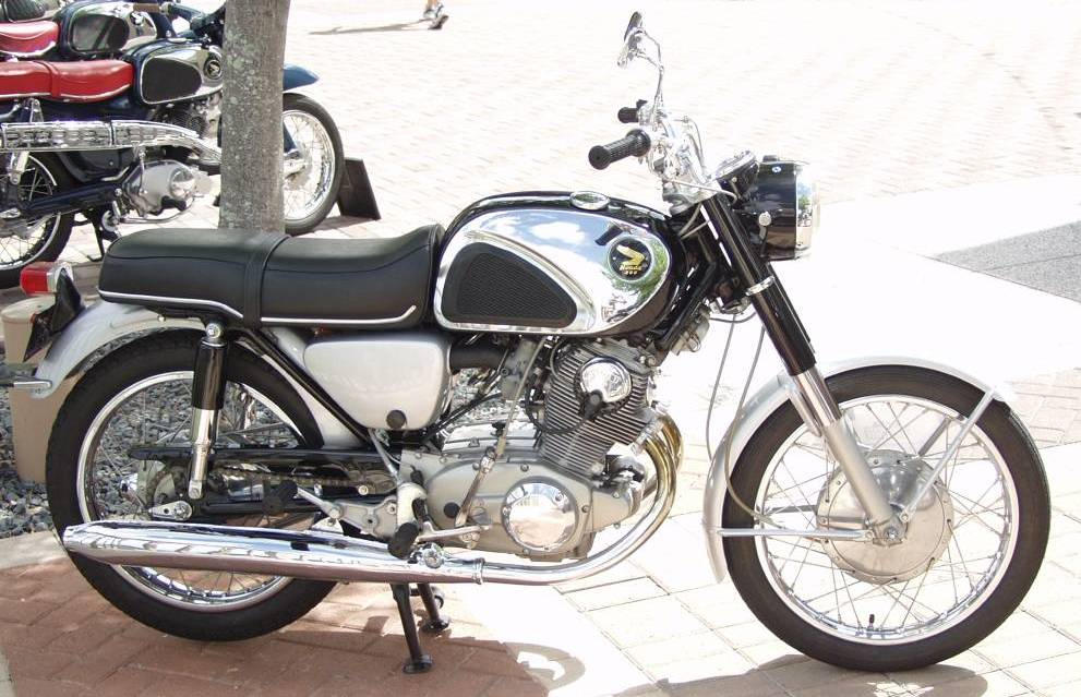

My front brake cable is 41", so that 44" jobbo probably isn't the right one. Which handlebar are you binning? The intermediately-raised or the American-cruiser-high? See pics. If you have intermediates, measure your front brake cable and if it's around 44-45" then the cable you're being offered isn't the right one for flats. I've no idea of the increments applied to the cables' lengths between the different 'bars, but I'll bet LM can shine a light on this one.
I'm interested to know the results.
