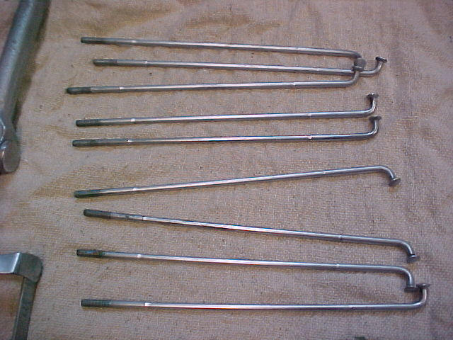

Rob, funny that this all should come up! I have had spokes replated in cadnium, and have not had any problems with them. I just bead blasted a set of CB77 front spokes, and have plated about 10 of them so far. The zinc sticks fine, I don't use any acid when cleaning. I have also been using Buchannons SS spokes for years, and have never had a problem with galling. They include a little bottle of what looks like a cross between gear oil and grease. It's usually enough to do about 3 sets of spokes. I use the left overs on wheels I do with replated spokes.

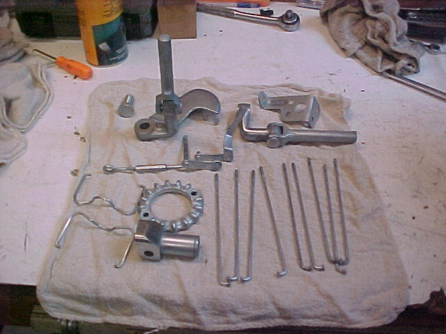

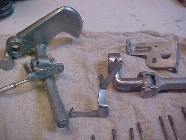

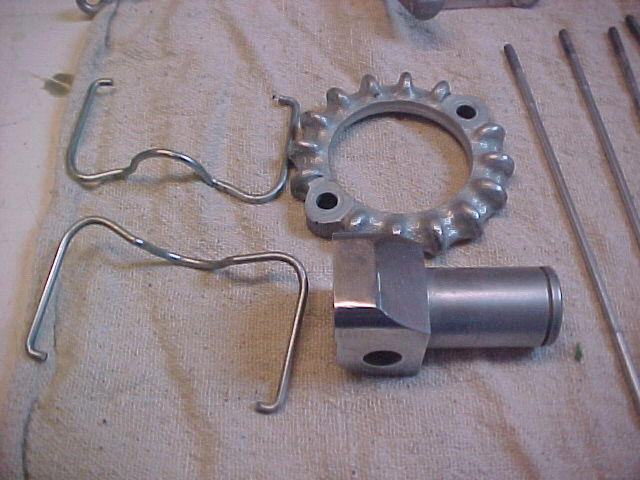

Hello, my name is Davo, and I'm a plateaholic!
I've been watching these plating threads, and wanting to try it myself. I went out and bought all 3 of the ingedients, about $12, a 50ft roll of zinc, $28, found a suitable container at the house, no my wife has not seen it yet, and started plating away. As others have stated, the zinc need to soak in the solution for a day before it really starts working well. The parts come out of the solution looking blue / grey. I scrub them with 0000 steel wool, and for the larger parts hit them with Mothers for an even shinier finish. I admit it, I'm hooked! Here's some pics of the results.
Davo

Davo,
Really glad to see you are enjoying yourself. I'm guessing everyone will be getting zinc plated Christmas presents this year.
Parts look good. I see you did the bale wires on your carbs. I need to do those myself.
Thanks for the info on what Honda used to plate their spokes. I would think that all you would have to do is degrease the spokes well and just replate, without stripping the old zinc off. Reading thru the Caswell plating forum, they said plating over old zinc is fine as long as it is degreased.
While on the subject of Caswell, I read thru quite a few of their FAQs and it appears there are a number of folks having problems with blisters forming in their plating. Caswell said it is trapped grease. Caswell said you need to thoroughly degrease prior to any blasting because the blasting drives the grease into the steel. All I did was wash my parts in semi-clean min spirits prior to any that I blasted. I would dip them in acetone just before plating. I've had zero problems. It looks like when you buy those high tech plating kits, they come with high tech problems. I've always maintained that the KISS principle should be followed in all endeavors. This homemade plating set up bears that out, once again.
