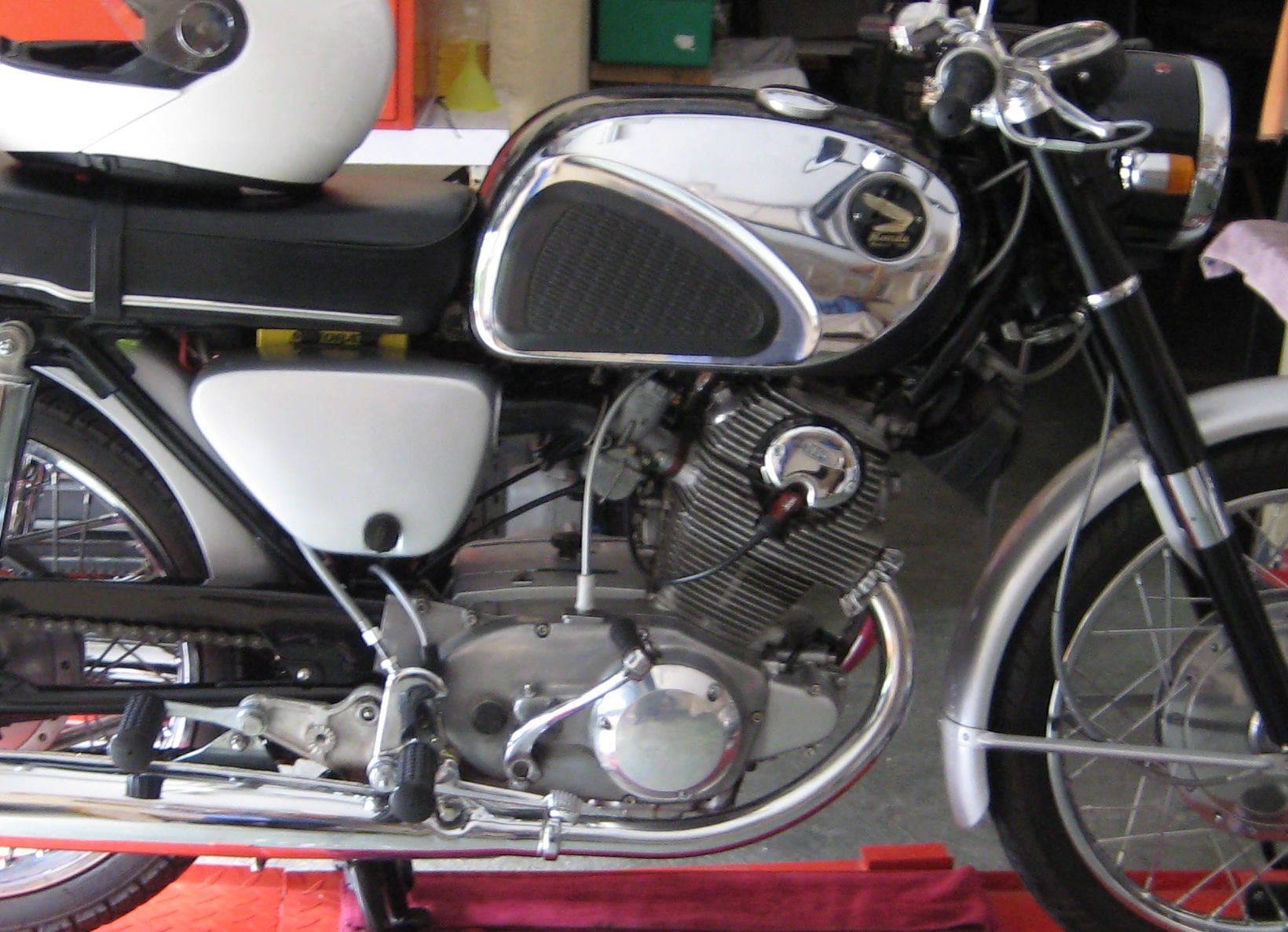

The CB's routing is quite straightforward compared to the C/CA models. See images below.
Incidentally, from the levers' perches, the clutch cable passes between the front brake cable and the headlamp; i.e. ahead of / in front of (left over right).

throttle cable
Post by jleewebb » Mon Oct 08, 2012 10:59 am
Note too that the throttle cable splitter should rest on top of coil for smoothest operation as shown. Hi Steve!
