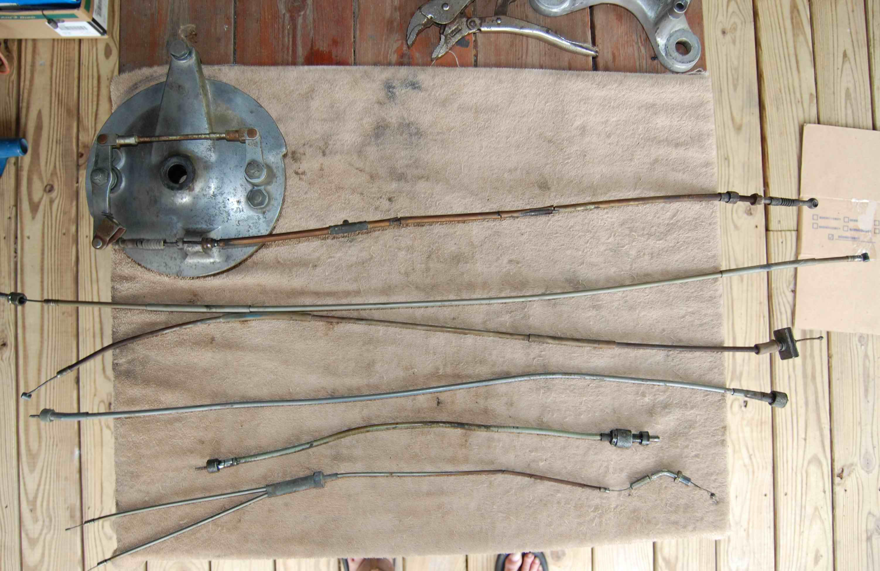

for what it's worth, my '62 cb77 with factory low bars  is mostly disassembled, cables are all in one place, so i measured them.
Throttle: 17" from split to handlebar, 30" overall.
Clutch: 39" overall (from end of connector to end of connector)
Front brake: 44-1/2"
Rear brake: 32-1/2"
Tach cable: 20"
Speedo cable: 34"
I don't know if this helps or confuses the issue since sizes vary from others posted. They fit fine on bike before I pulled them off, didn't notice any excess slack or tightness. Not sure if any have been replaced, some memories fade in old age...if original, then may have stretched some in 20k miles.
Most of my cables are in good enuf shape to clean up, lube, and reuse, except for back brake (badly cracked sleeve) and throttle cable which has a couple of broken wires at grip end. These parts seem affordable enuf to replace and not have to worry about old ones failing.
I'll no doubt be using forum in future as i go through my restoration, so thought I'd participate here to sortta get my feet wet...thanks, lee webb

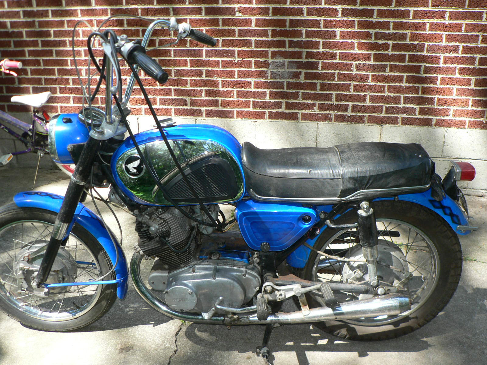

oh sorry, never heard of "binning" i thought you meant buying. i had really high bars on, almost like apehangers, they were on the bike when i bought it.

My ribs ache from laughing at your pic! No offence, but no wonder you're changing out there! Sorry, but I hate that type of handlebar.
Seriously though, I have to admit that, although the flat 'bar gives a CB the best look, it ain't the most comfortable of riding positions. I reckon the intermediate height probably affords the best compromise to return looks over comfort. I did have serious hand-numbing from my 444-mile delivery ride (described in these threads somewhere); you do tend to put a fair amount of your body weight on your hands & wrists with the flat 'bar in order to get comfortable with the rest of your body. I don't have the later lip-up seat, as you have, though.
I guess it'll end up a matter of personal preference and how much time you intend to spend riding in one hit. I only do short rides now, as I live on an island and everywhere I can go to is an hour, max. My delivery was 13 hours across Spain, stopping only to take refreshments (me and CB) and adjust the chain & check the oil.
I think I'd be inclined to take a disc-cutter to those apehangers and mail them to the numpty who fitted them in the first place. But, like I said, personal preference. Maybe it was Peter Fonda or Dennis Hopper.......

yeah, i have no clue what they were thinking. the bike has been sitting since 1974 so the bars kind of matched the paint job, definitely early 70's style. This bike is going to be my play bike, I have a larger bike i ride for trips, and longer rides. I have never had a bike with low bars so thats why i am going with them,,and......they look cool. Maybe when i get older i might have to change to the mid rise bars., and if i decide to ride longer, but like i said this is definitely going to be my pleasure bike, if i get tired of riding i will pull over and rest and take in the views! by the way i am going back to the black and silver paint scheme. In that process now
