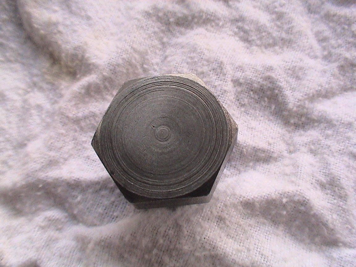

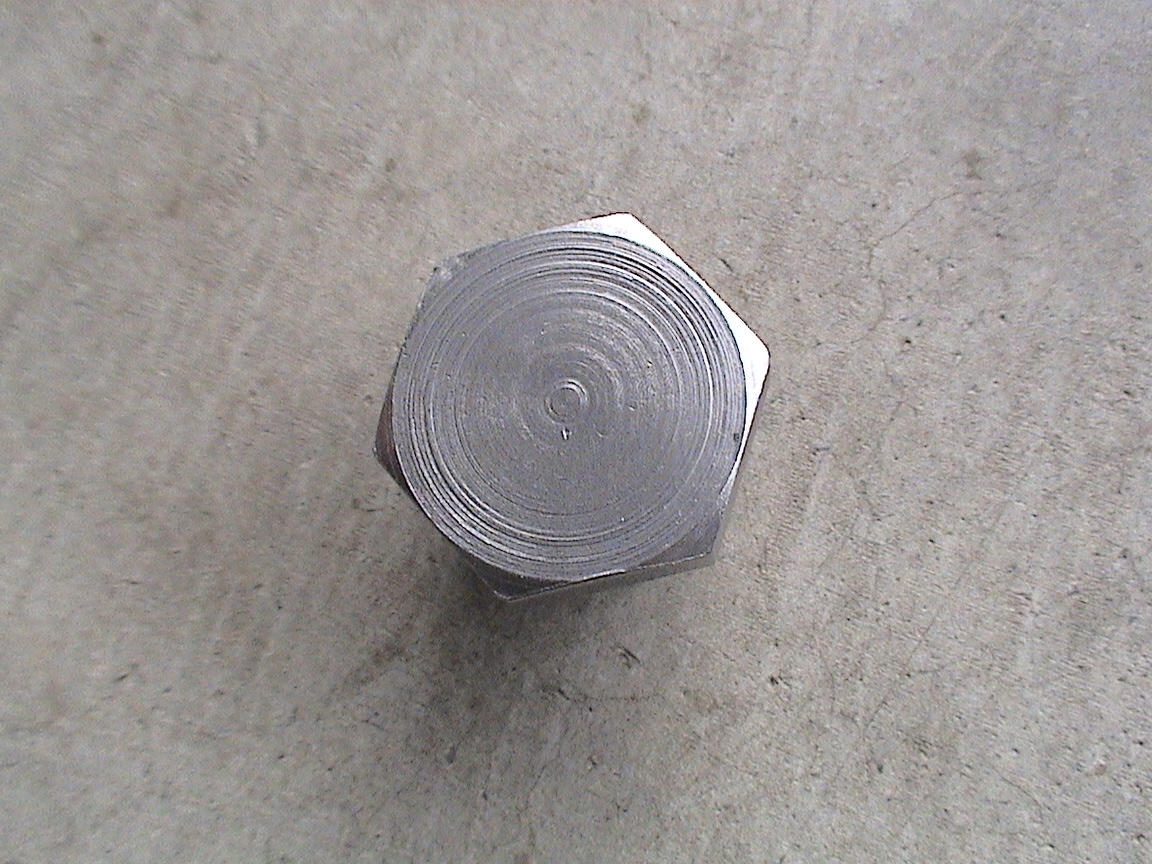

Post by brewsky » Sat Apr 14, 2012 6:02 pm

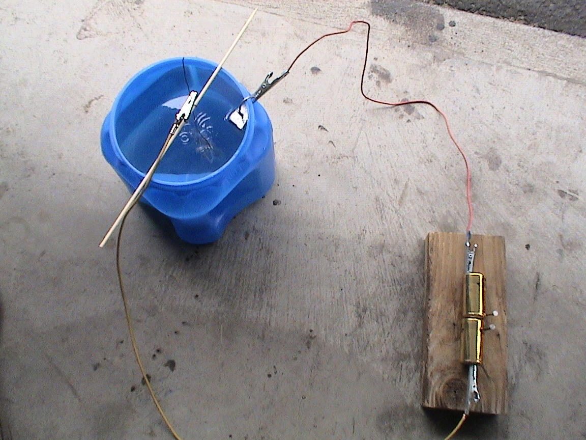

Finally got around to trying this out myself......low budget setup below:
1/2 lb white sugar
1/2 lb epsom salt
2 qts white vinegar
2 C batteries (in series)

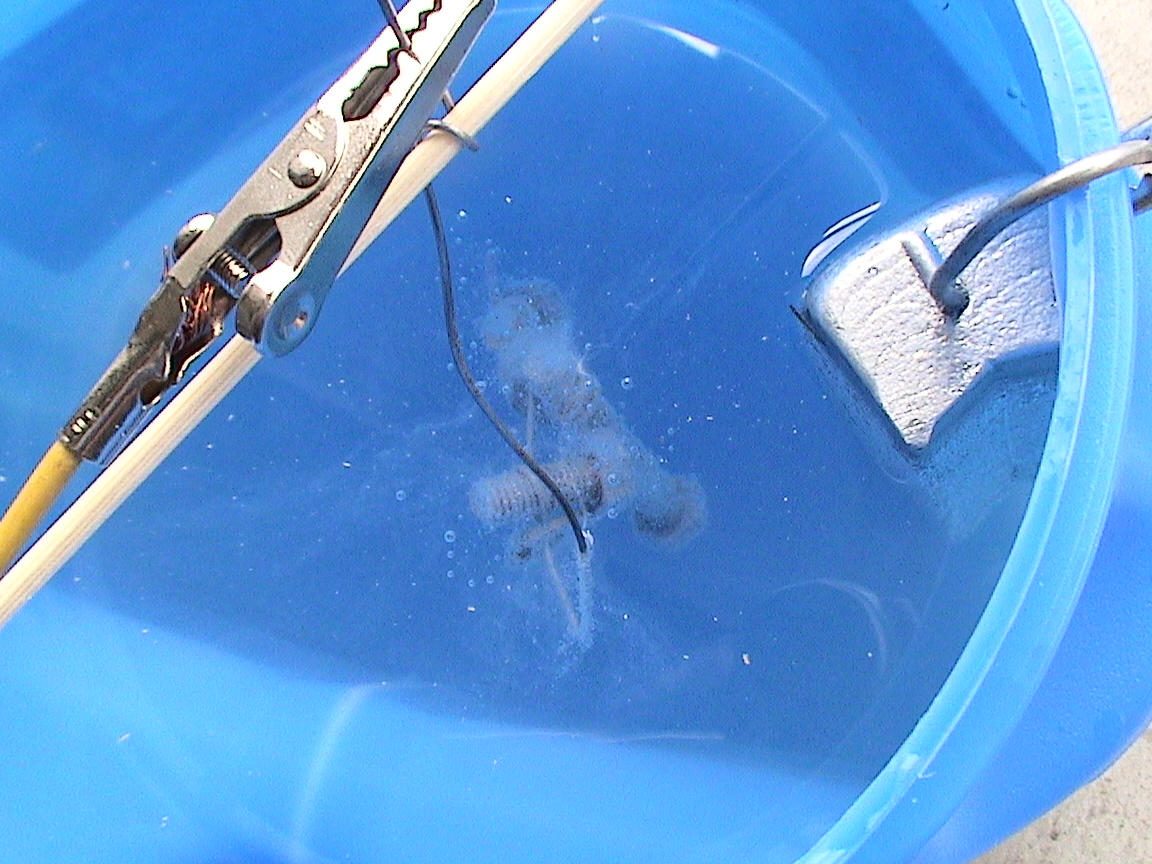

1 slug of zinc anode from local hardware store ($14.00 OUCH!..only local source I could find)
Got around 300 milliamps depending on how close the anode was to the target.
Lotsa bubbles!
