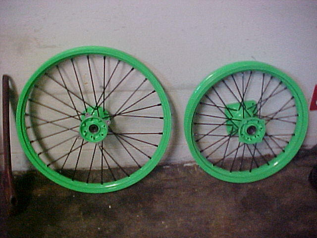

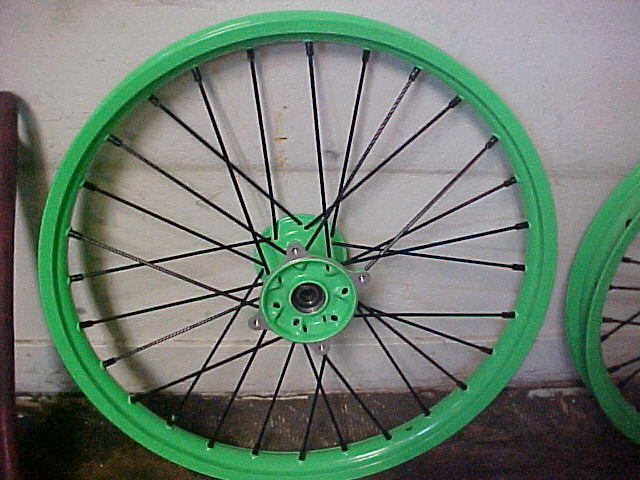

Rob, here's a set of powder coated rims and spokes that I laced up this morning. I highly do not recommend powder coating the nipples, as there was powder coating in the threads, and it took a lot of time and effort to clean them out. It also made the od too large on a bunch of the nipples, and was tough to get the spoke wrench on them. No they aren't for a 305, they are for a CRF150R. They are done in the same colors as my friend's road race team's wheels.
