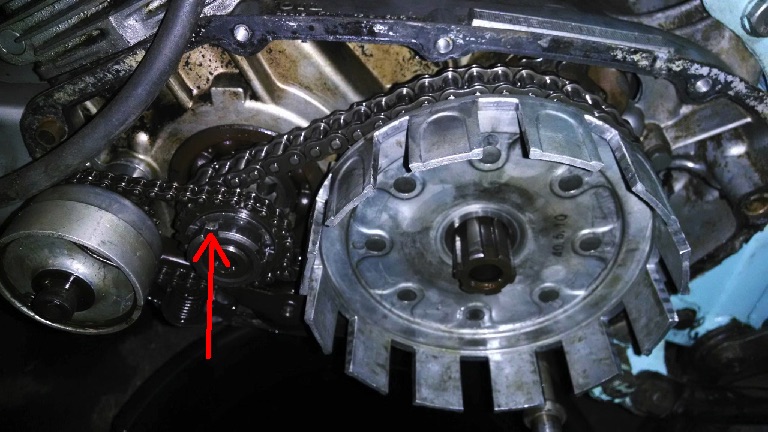

I got the cover off, I didn't realize at first that one of the screws holding the cover on is also the screw for the oil pump cover. Doh!
Anyway, I took the clutch plates out, they measure correctly. I was trying to remove the clutch basket with the chain and sprockets attached my repair manual does not explain how to do this. There is a washer with a bent down tang that I think is holding the whole thing in place. Honestly, I don't know what I'm looking for but as I understand it now that I can see some of the inner workings, when I move my shift lever I can see an arm moving behind the clutch basket, I think that's what connects to the shift drum. We'll see once I get this sucker out.
I do already have the oil pump and chain off.
- Clutch Basket.jpg (119.05 KiB) Viewed 3411 times
