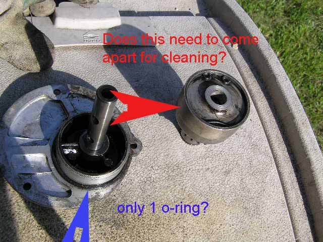

1st is of the oil filter, do i need to take this apart for cleaning or just wash it ?
and i only see 1 o-ring i thought there was 2 or does this differ by years?

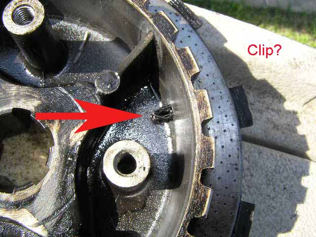

2nd. pic is of the clutch assembly, when i removed the clutch plates i noticed that 2 plates and 1 clutch disc remained ? i also noticed that there was a CLIP in the basket is this holding the plates in? how do i remove it just pull it out and does it go back in the same way?

You have an early small hole cover. It has one o-ring inside the large cover, and on on the small cover.
Remove the snap ring from the oil filter, and carefully punch the cover out from the backside. You'll probably have to clean the hole for the shaft up a bit after reassembly, make sure the filter spins freely on the shaft.
Use a pair of needle nose pliers to compress and push those retainer wires up through the clutch hub. Depending on what plates you use when rebuilding, you may or may not be able to reinstall the wires.
